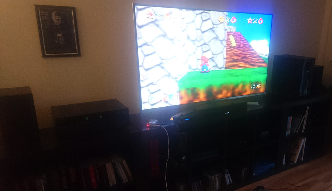

                  Look at this
                  N64 on my PI2 (for testing purposes), with recalbox 4.0.2 on my 60", 4k UHD, LG 60UH8509, running in fullscreen without any problems, being connected via HDMI.
                  • Shaders are set to none
                  • Pixel Perfect is deactivated
                  My TV has "Mode 16 CEA" as preferred mode, which I have put in my recalbox.conf so the two important parts look like this
                  ## Set game resolution for emulators
                  ## select your mode from the command : tvservice -m [MODE]
                  ## CEA 5 HDMI : 1920x1080 @ 60Hz 16:9, clock:74MHz interlaced
                  ## CEA 4 HDMI : 1280x720 @ 60Hz 16:9, clock:74MHz progressive
                  ## use 'default' for using the default resolution
                  ## (string)
                  global.videomode=CEA 16 HDMI
                  and
                  ## N64 emulator is configured to display a screen with a 640x480 resolution (native n64 resolution)
                  ## So you must use one of these video modes (DMT 4 HDMI,CEA 1 HDMI).
                  ## If your screen is not compatible with one of these video modes, please check the recalbox's wiki.
                  n64.videomode=DMT 4 HDMI
                  ## If you are using a CRT screen, please change the setting above with this one :
                  # n64.videomode=default
                  Everything else is left untouched
