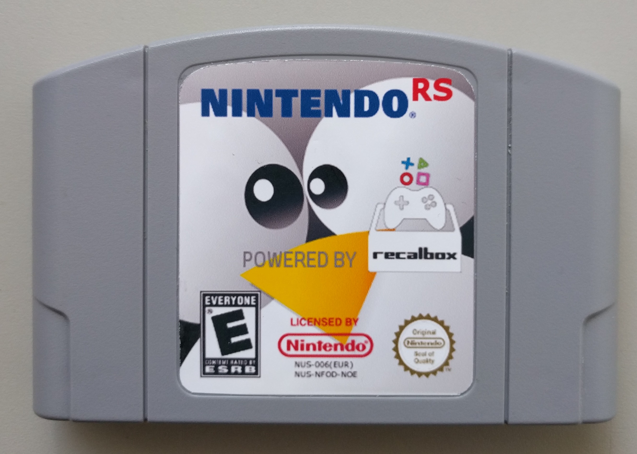

                    • lackyluuk
                      First draft of my cartridge. The penguin should represent linux 😄
                        Substring last edited by
                        awesome !
