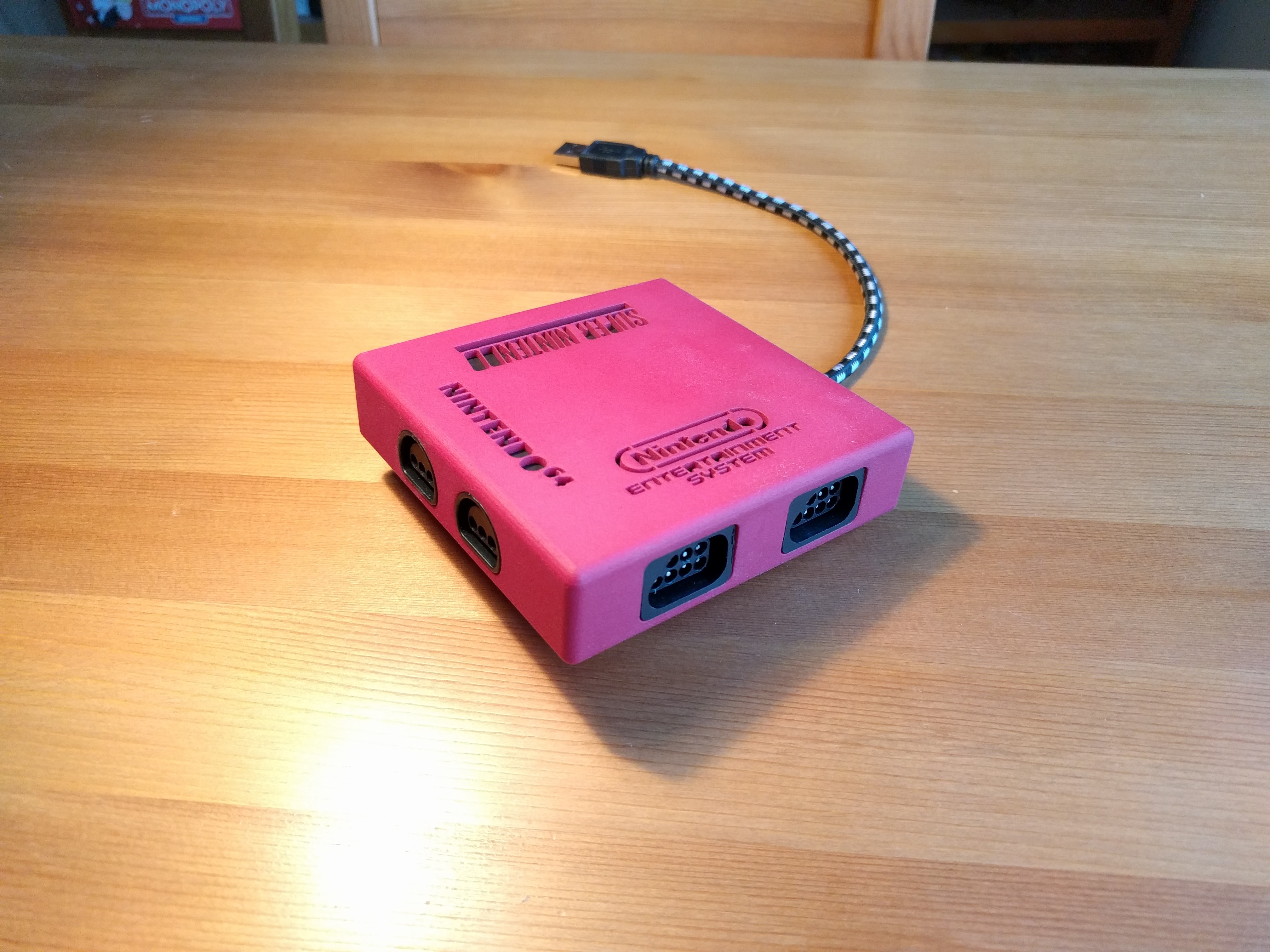

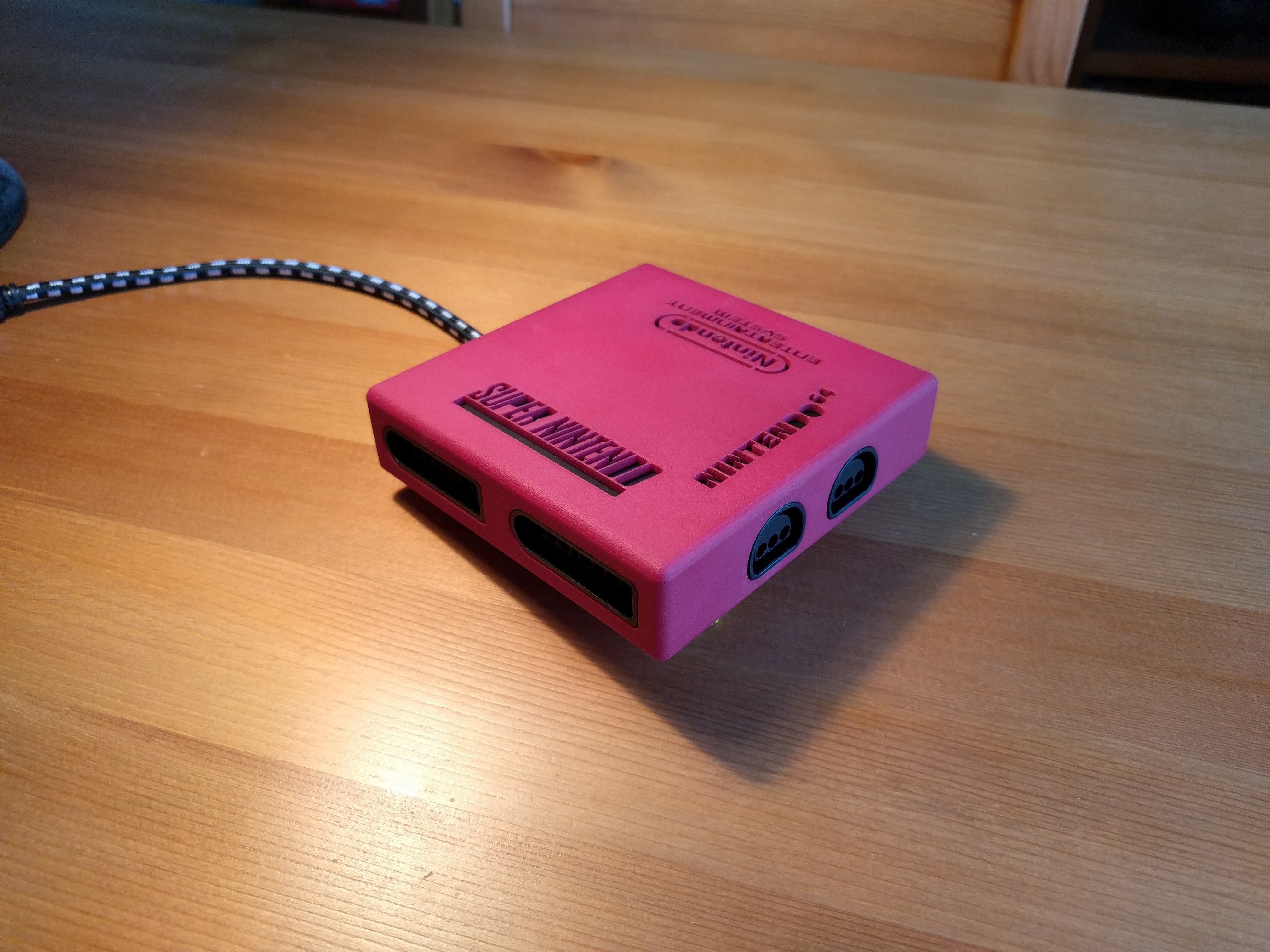

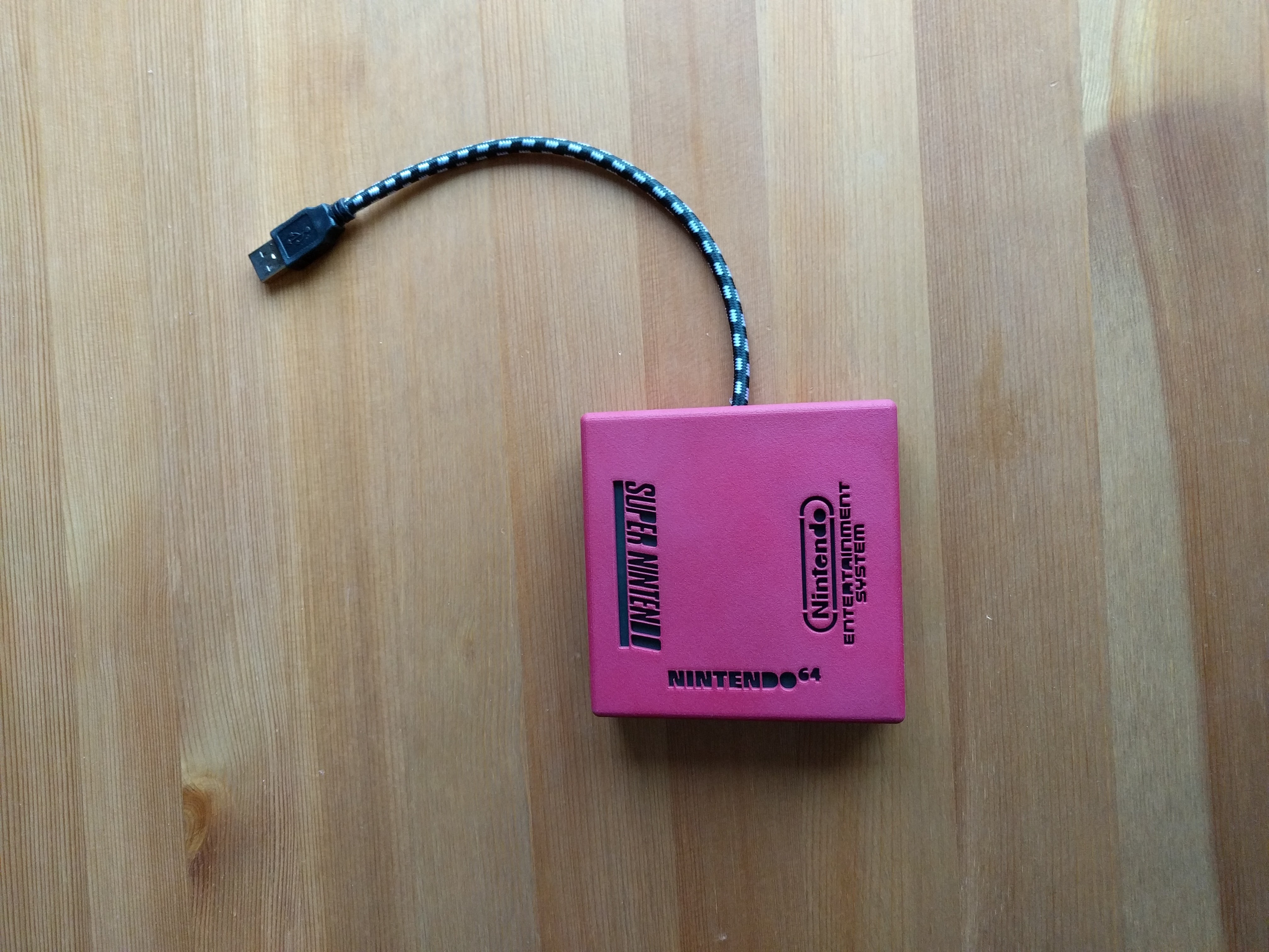

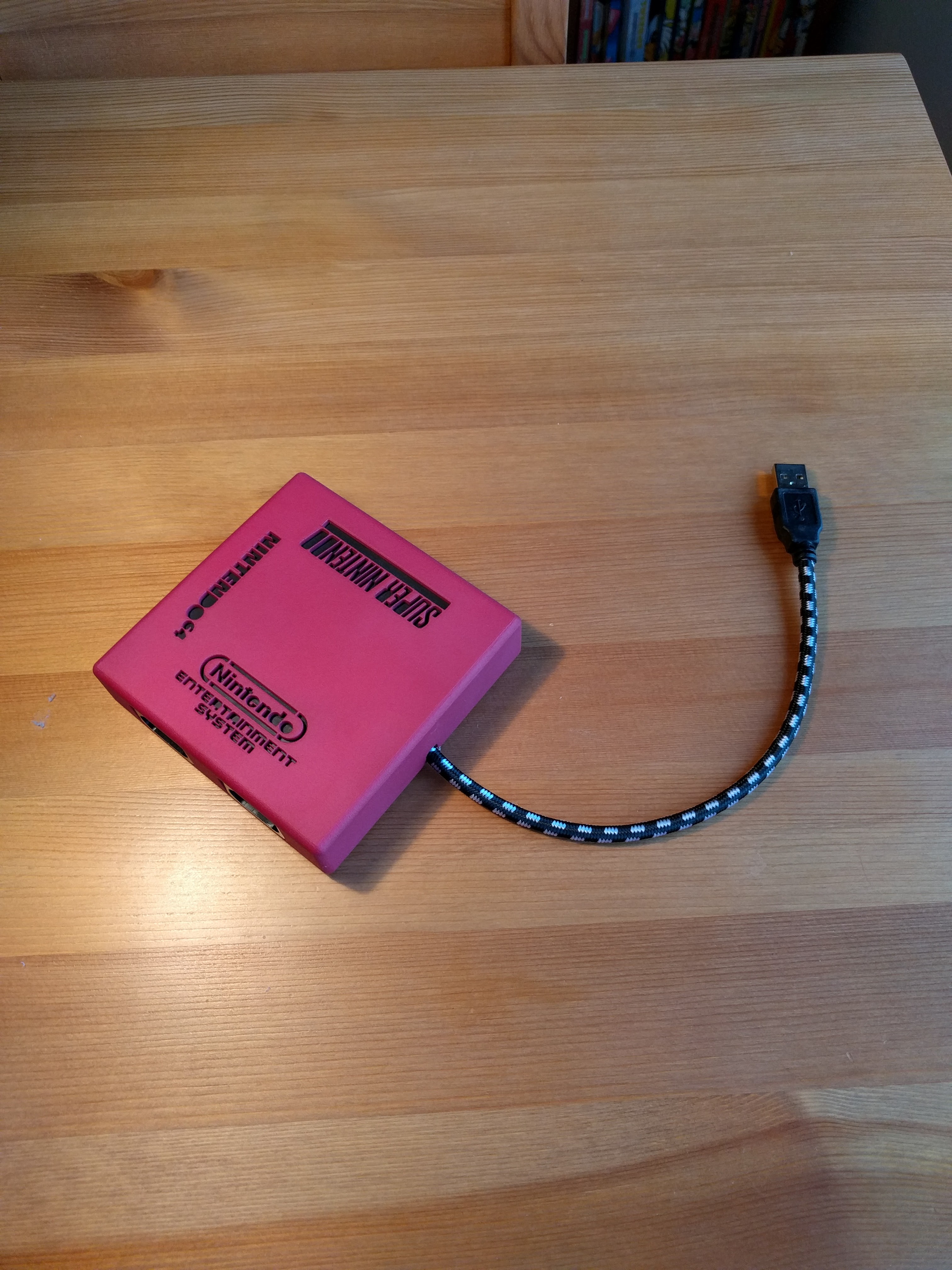

      I would like to introduce my new Nintendo Adapter Box for recalbox
      You can plug in the original controllers for the following systems:
      • NES
      • SNES and
      • N64
      and then just plug in the USB cable to your recalbox.
      Here are some pictures 🙂

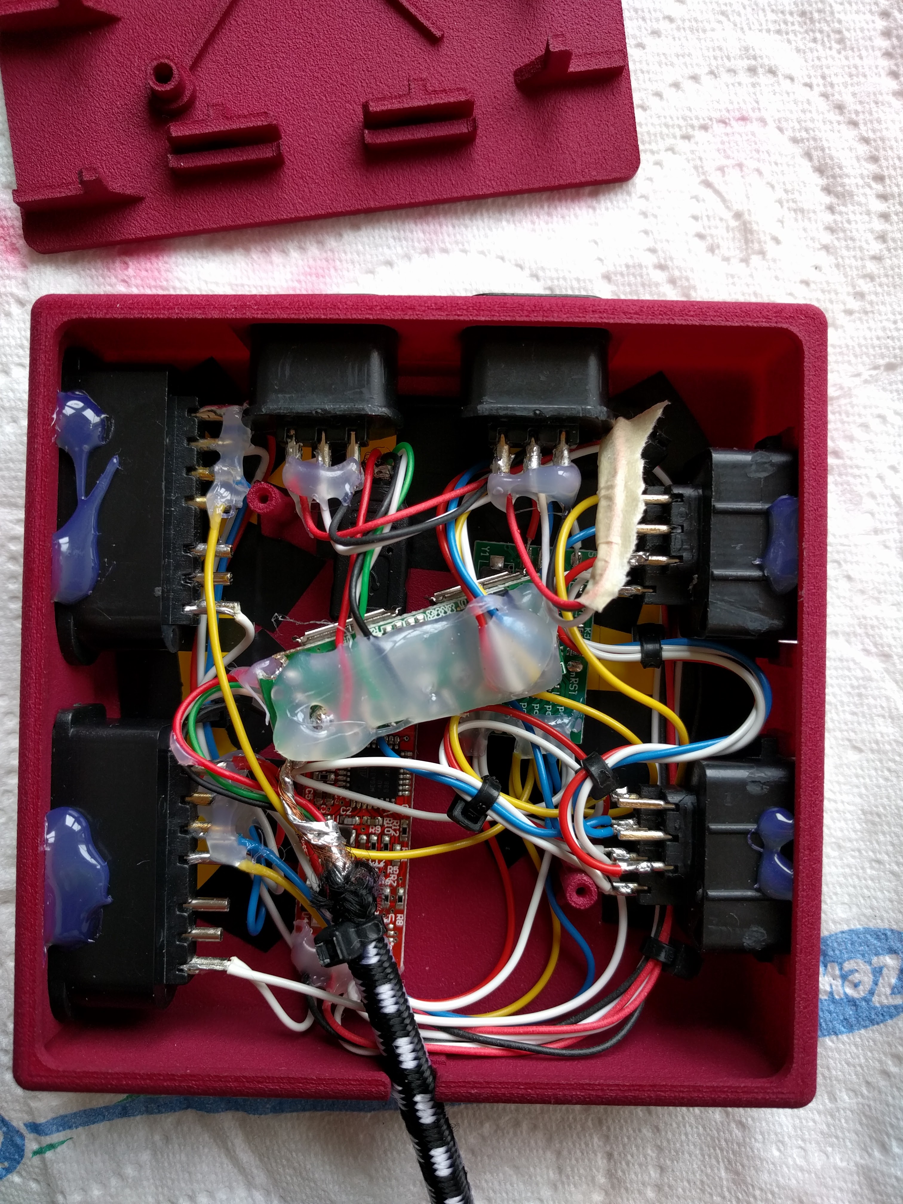

                  Here is another pic from the inside..its a little bit messy 😕
                  Actually there is no need for additional glue. I just put it there to fix it. The cover / lid (see next to the box) holds all the connectors properly 🙂
