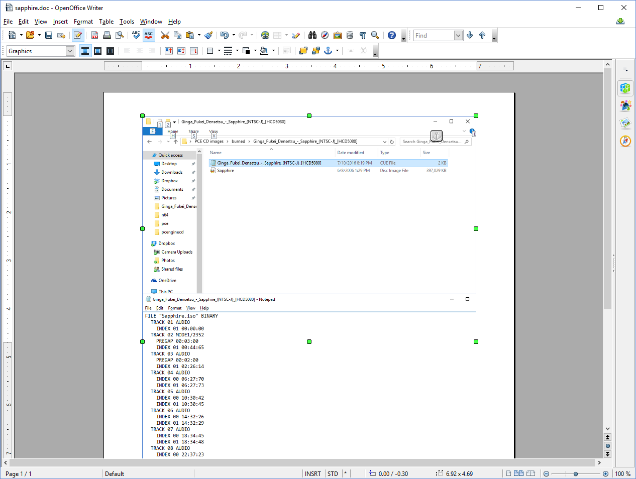

                    • metzger130
                      metzger130 last edited by
                      This is what I have. Does anyone see something wrong?

                            acris last edited by acris
                            Your cue and iso fikes must be same name
                            Your screenshot shows that it is not make
                            Sapphire.cue
                            Sapphire.iso
                            And in cue file Sapphire.iso BINARY
                            This game works fine in recalbox 4
                            • metzger130
                              @acris said in PC Engine Arcade Card games:
                              Are you looking at my 2nd screenshot or the 1st? if your looking at the 2nd, please tell me what you are seeing that I am not.
                              Sapphire.cue
                              Sapphire.iso
                                Arf i have look the wrong screenshot.
                                2nd screenshot is ok
                                Try with lowcase
                                All files with name sapphire.iso sapphire.cue etc....
                                Very strange this game works fine in my recalbox.
                                Do you use usb key storage or microsd card for your roms ?
