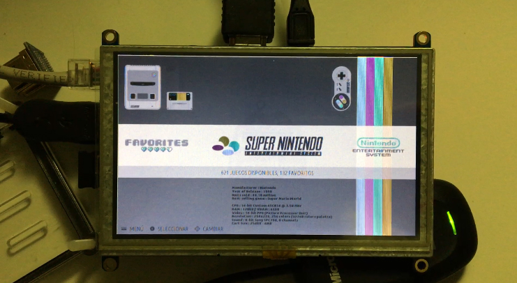

      i just bought waveshare 5 inch lcd screen
      http://www.waveshare.net/wiki/5inch_HDMI_LCD
      it worked ok. response time is good
      but it does not show full screen
      I've tried overscan on/off in the menu
      menu work nearly perfect but left the right side
      in game it's shown top left of the screen
      please advice
      Thanks in advance

        Actually it is working as expected as this screen does not own a scaler see : https://www.adafruit.com/product/2260. You need to configure it manually in the/boot.conf.txt and force the resolution. It is described in the wiki here https://github.com/recalbox/recalbox-os/wiki/TFT5-Screen-HDMI-(EN) and here at adafruit https://learn.adafruit.com/adafruit-5-800x480-tft-hdmi-monitor-touchscreen-backpack/raspberry-pi-config
        # uncomment if hdmi display is not detected and composite is being output
        hdmi_force_hotplug=1
        # uncomment to force a specific HDMI mode (here we are forcing 800x480!)
        hdmi_group=2
        hdmi_mode=1
        hdmi_mode=87
        hdmi_cvt=800 480 60 6 0 0 0
        max_usb_current=1

          thank you. i've done it
          but it only fix the menu (emulation station)
          but when i've try to play game
          it's still the same 😞
          • ian57
            ian57 Staff last edited by
            ok you'll need to modify the recalbox.conf like that :
            global.videomode=default
            to use the default configuration from the config.txt

              Tick Lpsk last edited by
              thank you .
              It work perfectly
              really appreciate 🙂
              one more thing
              is it possible to get rid of pink line on the left?
              • ian57
                Don't know, perhaps it comes from the screen. I have this problem on a 19" lcd screen too. Need to investigate further!

                    Is that line linked to the audio through hdmi ? Such things happen on DVI
                    • ian57
                      ian57 Staff @Substring last edited by
                      @subs +1 my screen with this violet border is connected with HDMI-DVI cable.
                        Substring @Tick Lpsk last edited by
                        @Tick-Lpsk which sound output are you using? You should give a try by disabling HDMI audio (please check the DVI wiki)
                        Tick Lpsk 1 Reply Last reply Reply Quote 0
                        • Tick Lpsk
                          Tick Lpsk @Substring last edited by Tick Lpsk
                          @subs thanks a lots bro
                          it work great now
                          i take a tut from here
                          https://github.com/recalbox/recalbox-os/wiki/Connect-your-recalbox-to-a-DVI-screen-(EN)
                          no more violet line 🙂
