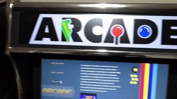

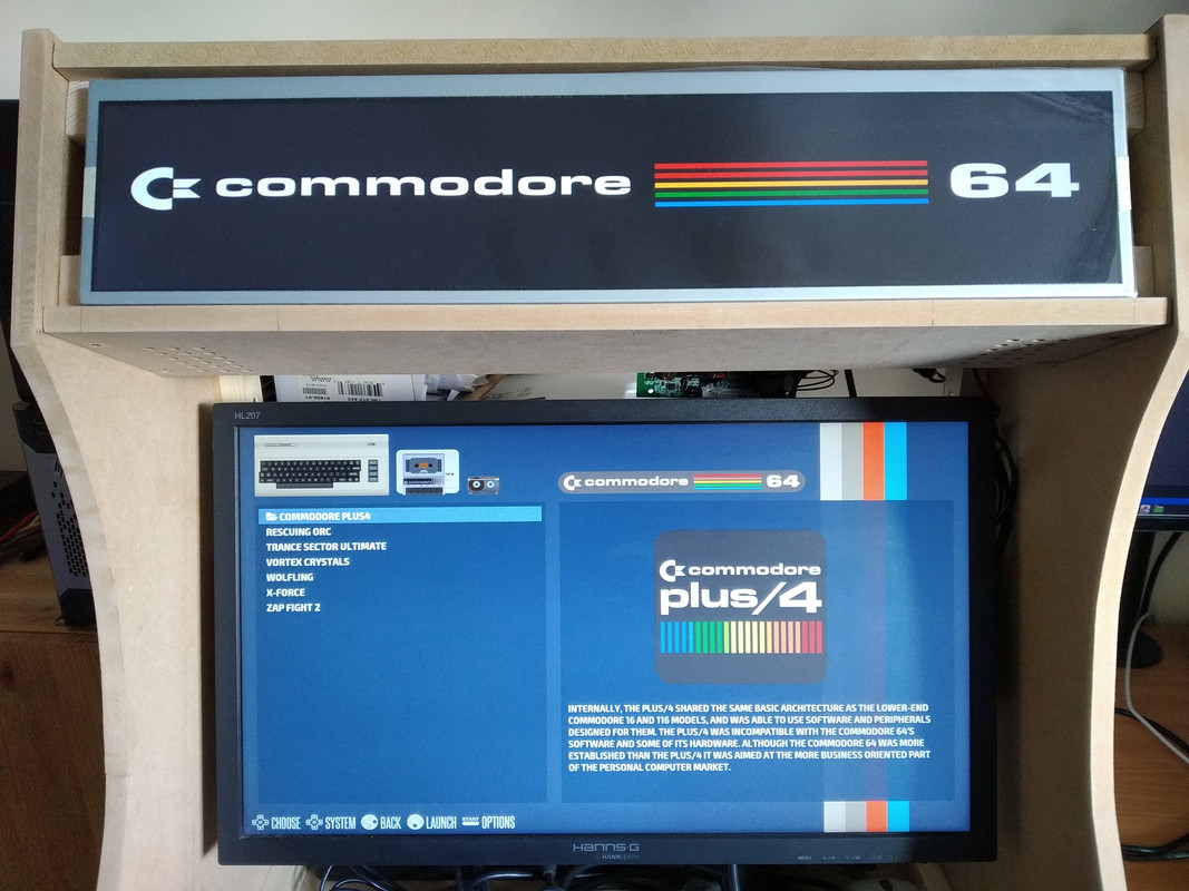

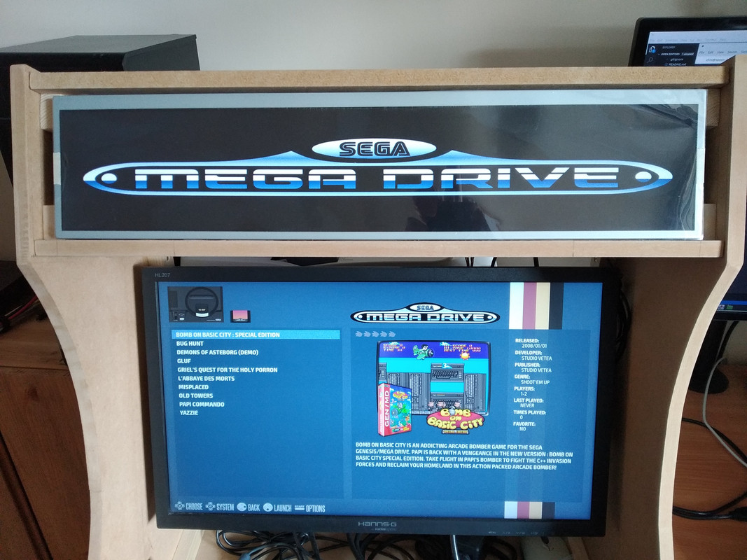

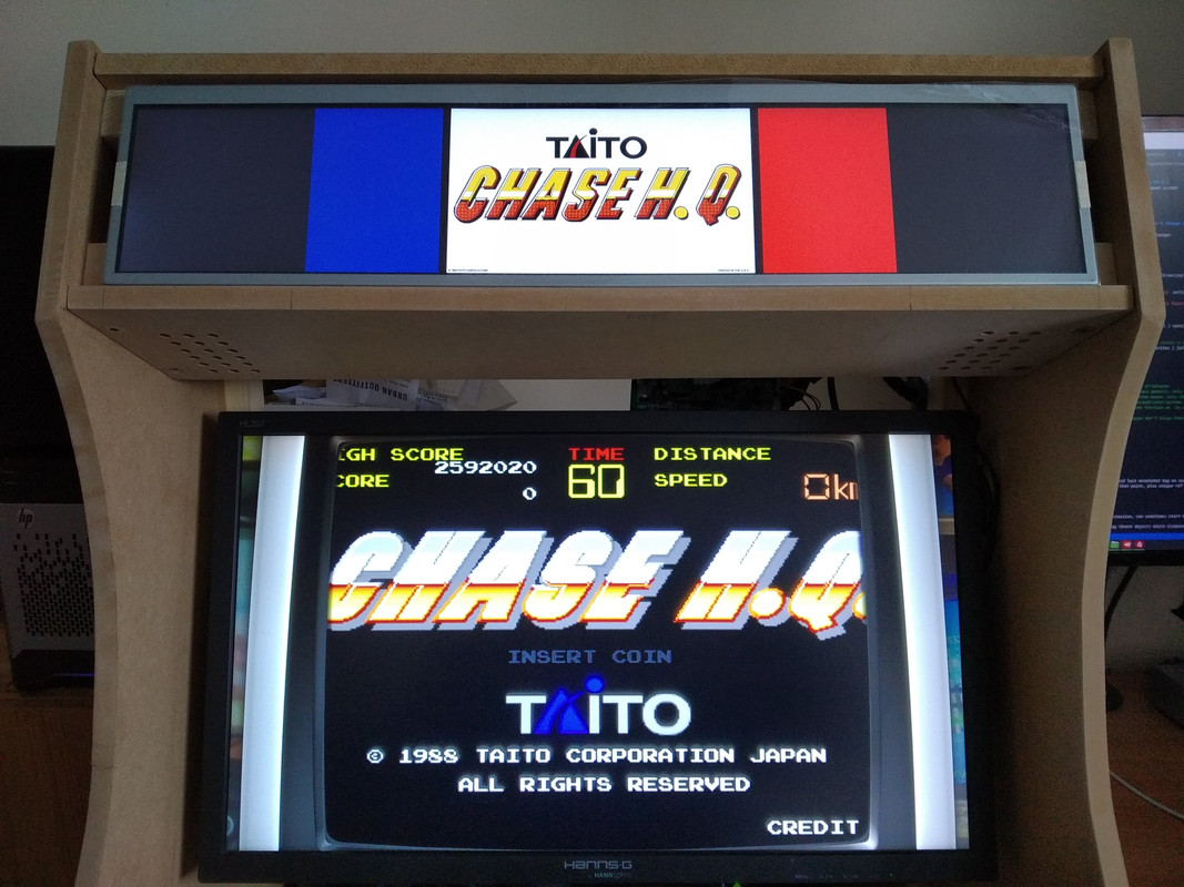

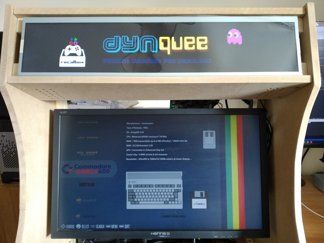

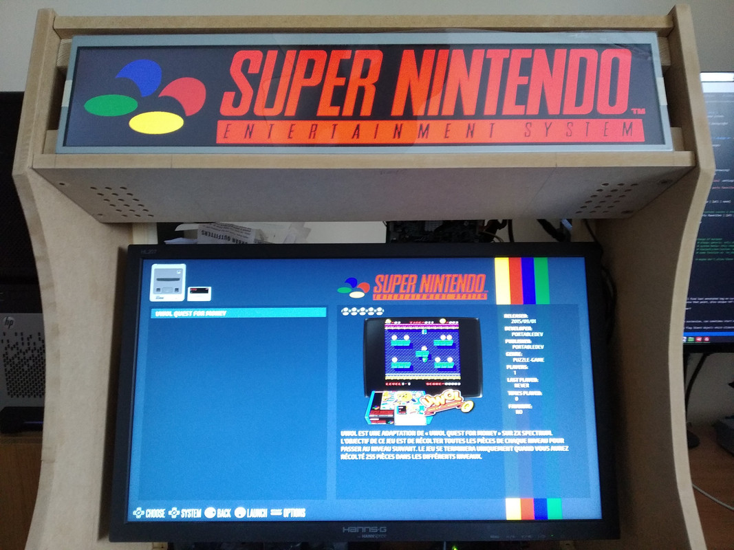

      I'm building a bartop arcade machine based on Recalbox and I wanted to have a dynamic marquee which can change depending on which game system is selected and which game is being played.
      As my Pi4 has dual HDMI outputs I wanted to drive the marquee from the second HDMI output.
      dynquee (say "dinky") is the program I wrote to do that. It's a bit over-engineered for what it does, but it seems to be stable now so I've decided to release it in case others find it useful (it has been asked for a few times before; see e.g. 1 2 3 4).
      For more info see the project page on github.
      All comments / questions / criticism welcome.
      dynquee startup
      dynquee megadrive
      dynquee arcade
      dynquee ChaseHQ
      dynquee Spectrum
      dynquee SNES
      dynquee Commodore 64

      • toniosj
        toniosj Spanish moderator last edited by
        Amazing!! Thanks for your work!!
        Two questions:
        1. Where did you buy that LCD?
        2. Does it work on Recalbox PC?
        toniosj poppadum 2 Replies Last reply Reply Quote 1

            • poppadum
              poppadum @toniosj last edited by poppadum
              @toniosj said in [SOFT] dynquee: dynamic marquee for Recalbox:
              I ordered it from Caison LCD in China - the model is DV190FBM; was not cheap though 😢
              If you can put up with a TN panel there are some less expensive options around e.g. here or here.
              1. Does it work on Recalbox PC?
              I've only tested it on Raspberry Pi so far, but I think it can be made to work. If you've already got Recalbox running on PC, I'd be interested in the output of the command ls -al /dev/fb*
              Does it work in Pi4 if I am using RGBDUAL ?
              Again, not tested but I don't see why not. Let's give it a try.
