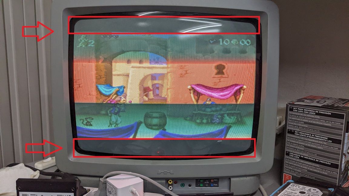

      Hi. as you can see on the attached image, when i play console games (snes or megadrive) on recalbox 8 , are visible black borders on the top and bottom.
      On ES menu i have tried to modify aspect ratio from auto to 4:3 but noting changed.
      Neogeo games looks fine, and also mame.
      I'm using recalbox 8 + pi2scart + pi4 + an old crt
      Thanks for your suggestions

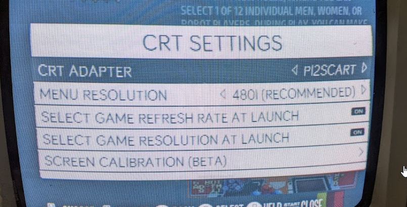

              Hi, @Zing i have a fresh new installation of Recalbox8, i have modified only crt system > pi2scart with resolution 480i racommended.
              I haven't edited snesvidemode, and overscan and pixel perfect are OFF

                If it happens only on a few games. It could come from the "zone" of the game (Pal/NTSC).
                Could it be 50 hz ones ?
                0zzy 2 Replies Last reply Reply Quote 0

                    Hi @greenalex i have done some test, i think you are right, i'm using a no-intro romset, european games have black borders top and bottom, USA not.
                    What can i do in this case?

                          @0zzy CRT timings are all sets in respect to the original Hardware timings. This means, the top/bottom bars are the same on the original hardware.
                          Since NTSC games use less horizontal lines than PAL games, you'll often get top/bottom bars.
                          0zzy 1 Reply Last reply Reply Quote 0

                            Hi @bkg2k , i have black bars on PAL games not on NTSC (pal image is also a little bit streched, we are talking about 3 cm video, not a few pixel lines)
                            I use the same romset on a PC with crtemudrivers and retroarch, PAL and NTSC games works both fine in a full screen CRT monitor

                              Pal games are starting in PAL mode 50HZ like on the original pal hardware :
                              there was black bars on pal games, as the mode was 288p with 224 or 240 pixel height games.
                              We are working on a option to select the mode of pal games when starting it : PAL or NTSC.
                              Just not implemented yet.
                              If you search well in the wiki, you can override modes : https://wiki.recalbox.com/en/tutorials/video/crt/recalbox-on-crt-with-scart-dac
