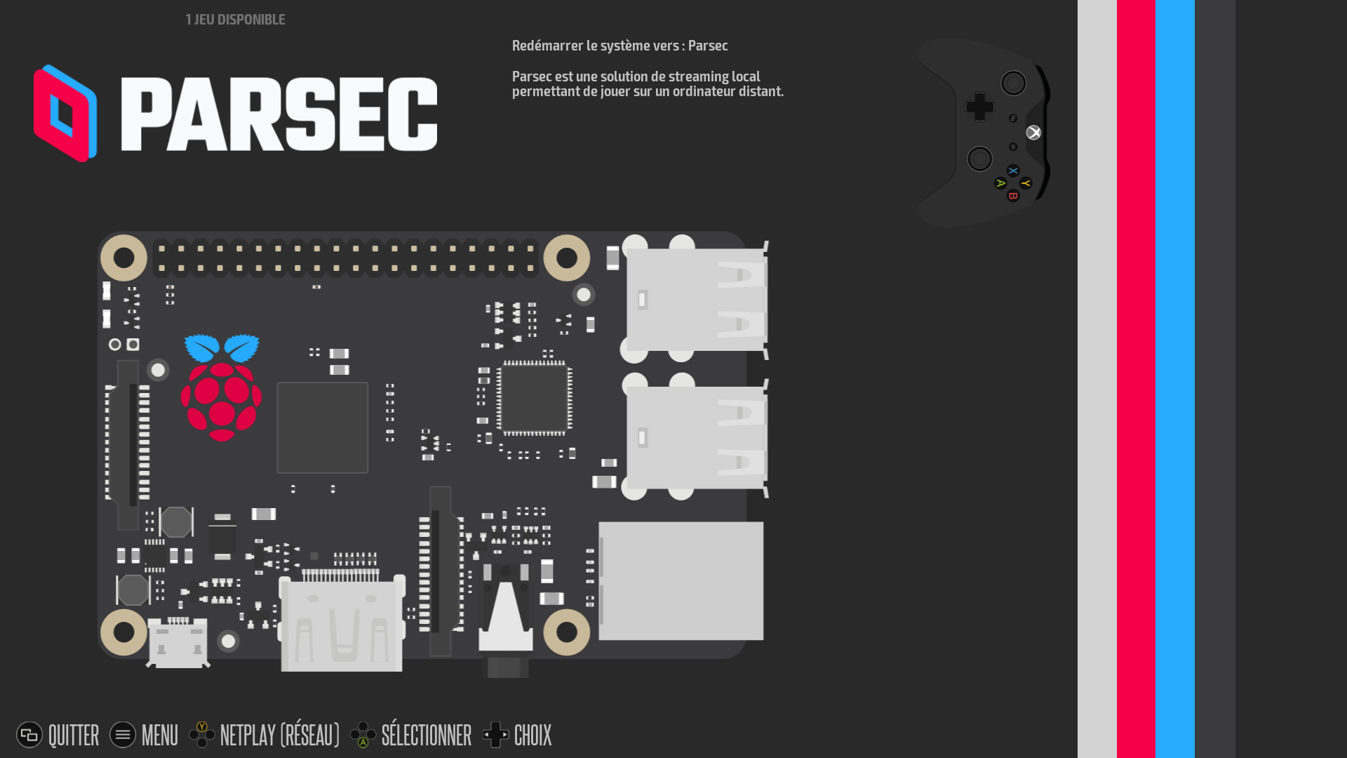

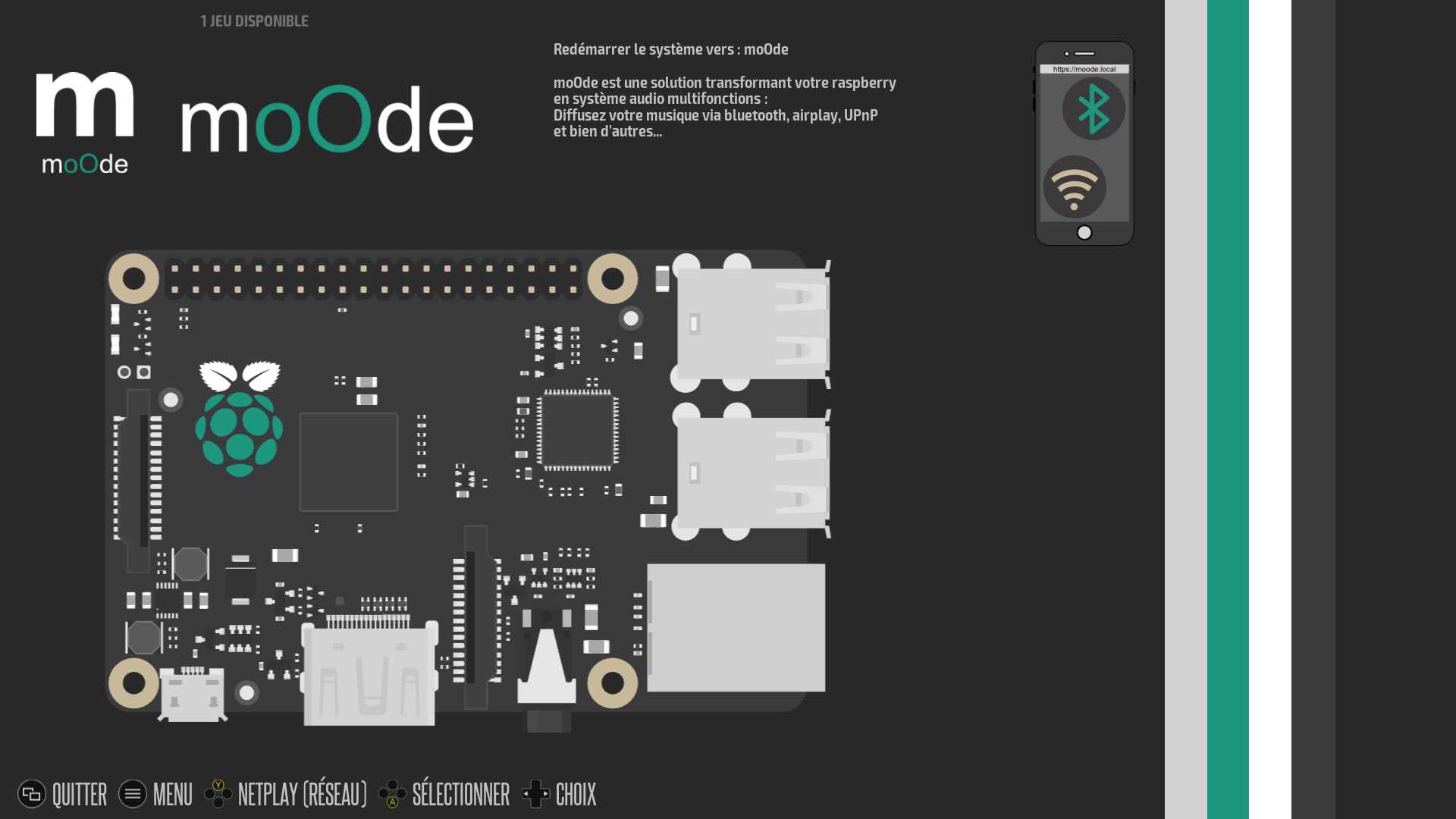

    • Some personnal systems for Recalbox-next theme
      Hello,
      I've made some graphic stuff for personal systems in the recalbox-next theme.
      I use these systems to restart my raspberryPi on another os (multiboot Recalbox / Pa**ec and moOde).
      As these systems are not related with recalbox (and therefore will not be integrated into recalbox-next theme), I make them available for those who may need this stuff:
      • Pa**ec theme
      • moOde theme
      • raspberryPi B+ board
      • Xbox One S controller
      This content is released under CC BY-NC-SA 4.0 licence.
      So fell free to copy/modify/redistribute as long as you give credit, don't use for commercial purposes and distribute (if you will) your contributions under the same license ^^
      posted in Themes & Interface
