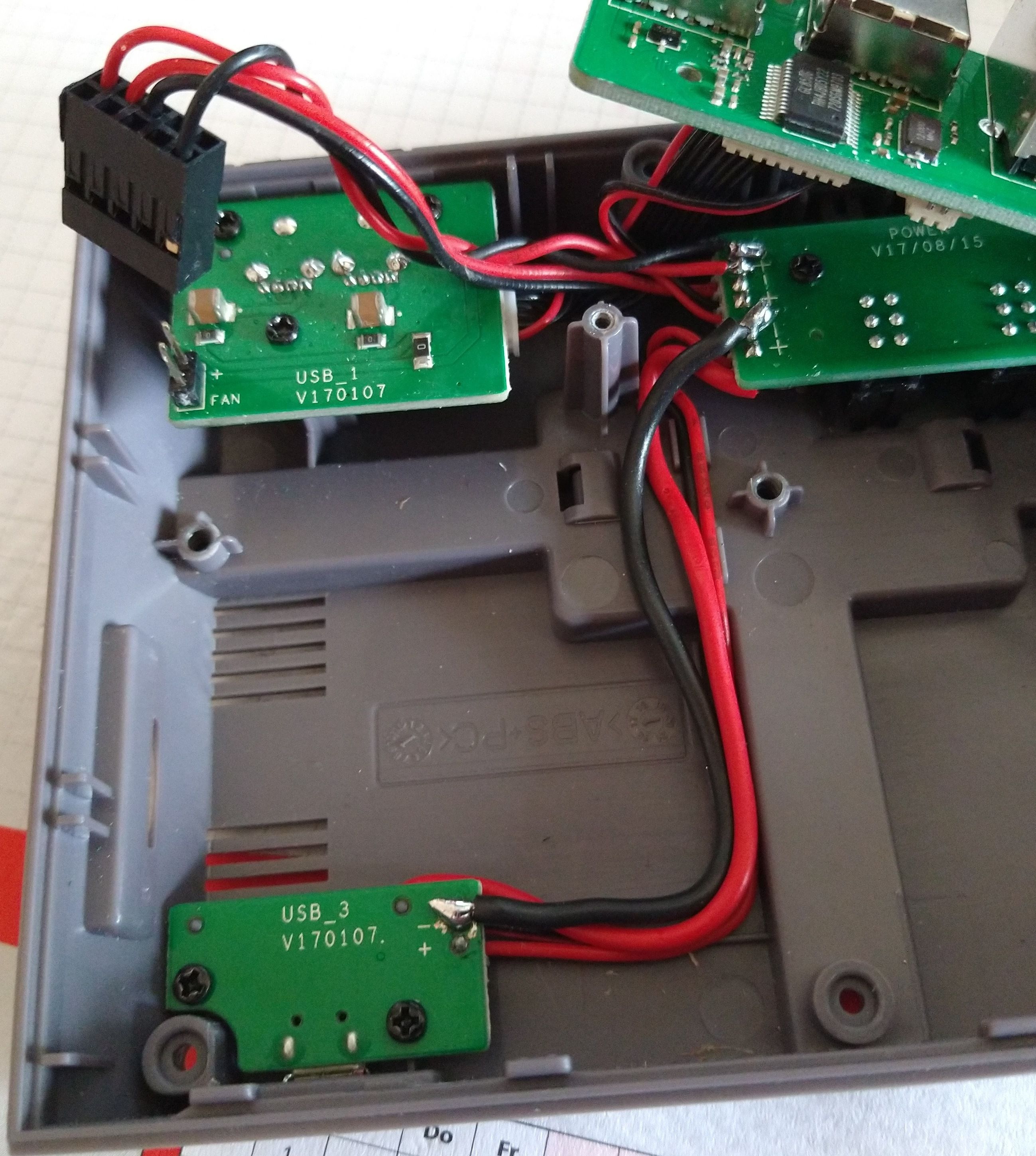

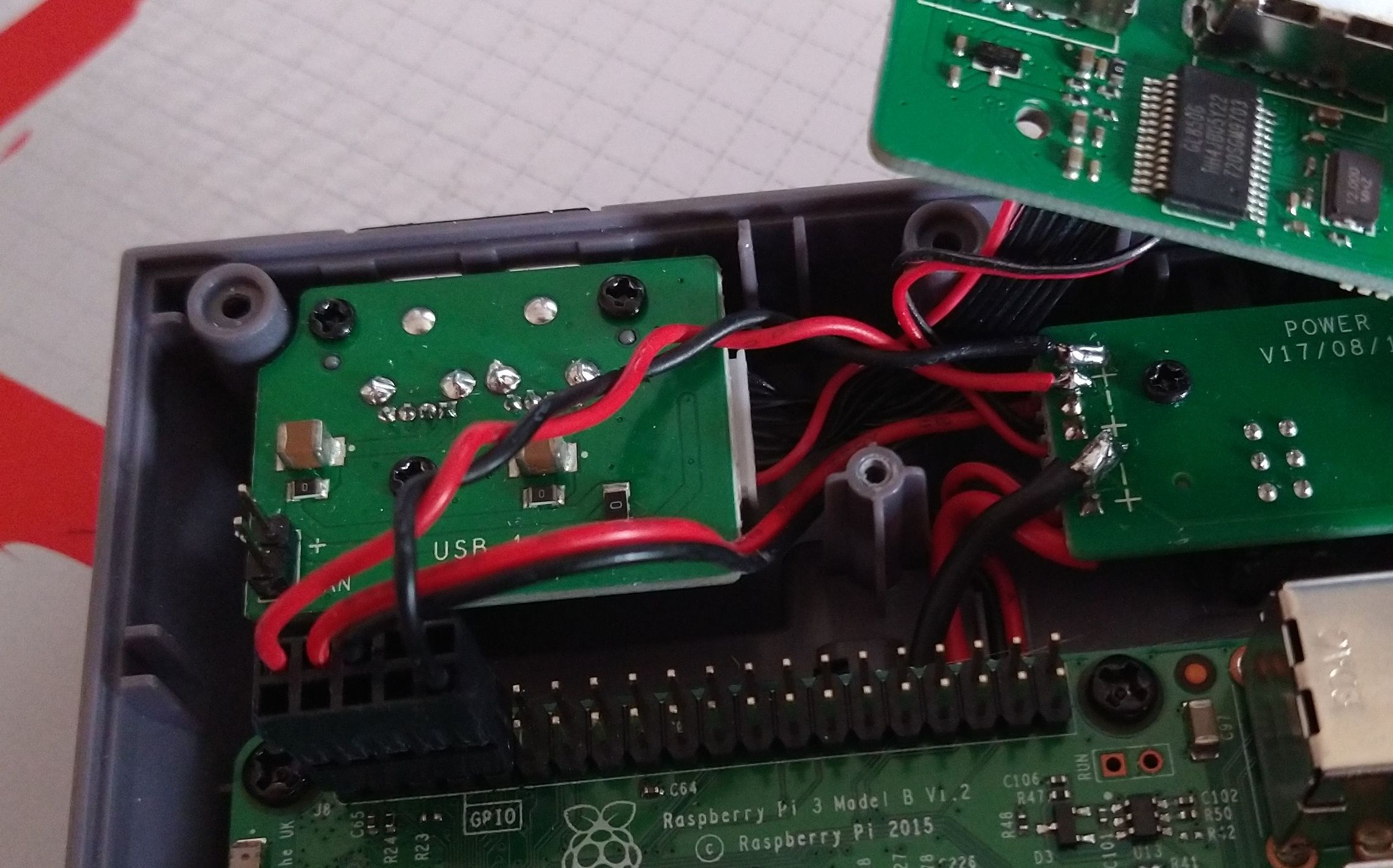

    • RE: Recalbox 7-Rbp3 Lightning bolt
      Of course.
      Here is a picture with the raspberry board removed. You can see the duplicate wires (original and new ones) from the USB connector board to the switch board, and from the switch board to the raspberry connector.
      Next one is a closeup of the connector with the raspberry board installed:
      posted in Recalbox General
      I had this problem too with a NESPi case (original one without '+') and a 2.5A power supply.
      So I replaced the power supply by one with 3A - no change.
      A direct connection of the power supply to the raspberry board resolved the issue so it was clear that the culprit is the NESPi case.
      After some googling I added additional connections from the USB port to the on/off switch board and from the switch board to the raspberry board connector. This fixed the issue completely.
      Because the existing connections were difficult to remove I decided to add additional ones in parallel. For the connection to the raspberry board, I added plug inserts and connected the parallel cables to other +5V and ground lines of the 40 pin connector.
      It's about 20-30 minutes work if you're capable of soldering. Better than throwing away the case. Because the case - besides being crappy inside - looks very nice 🙂
