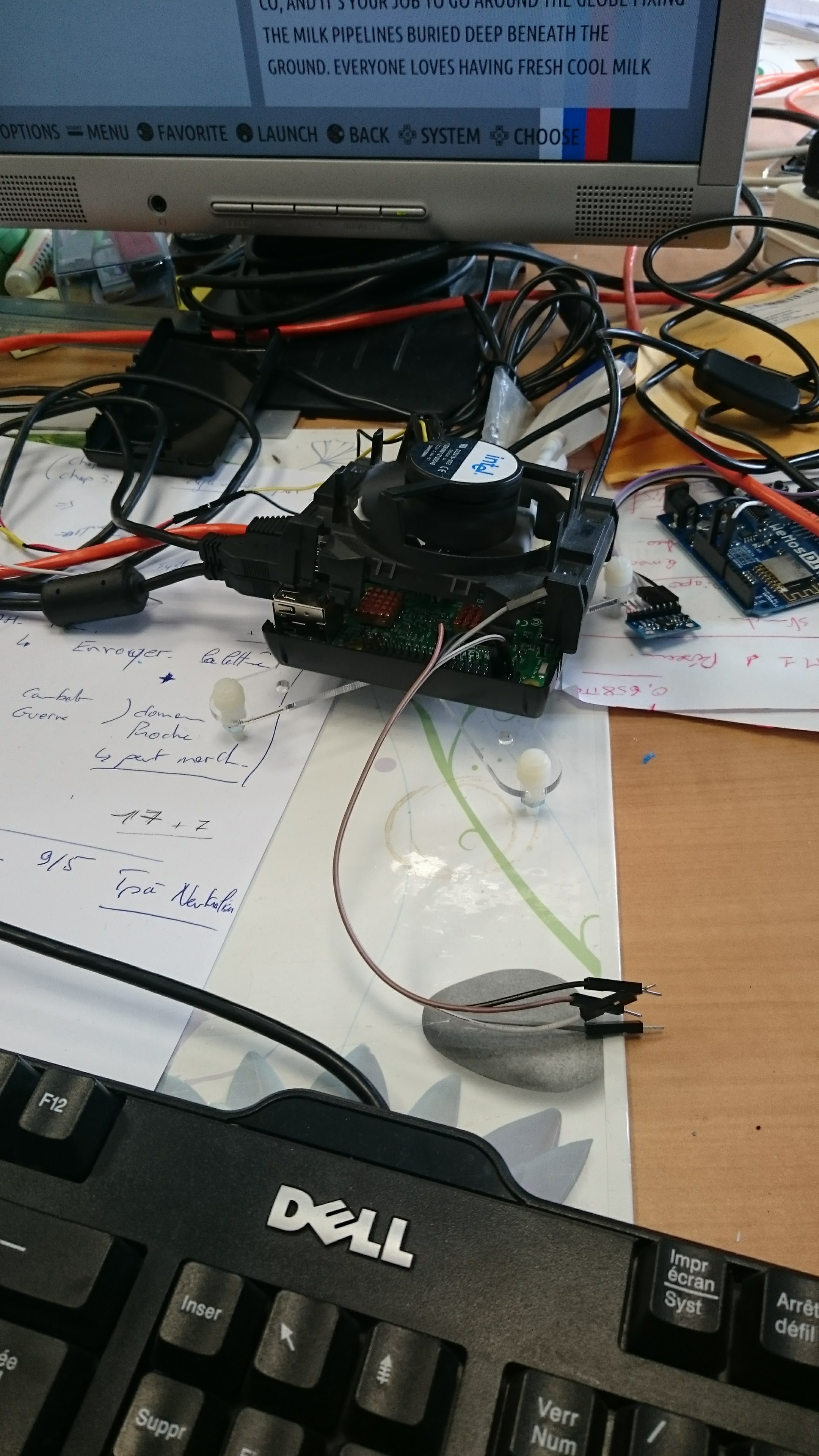

                      • ian57
                        ian57 Staff last edited by
                        @screech @allan la soluce de screech est ok en utilisant le GPIO. J'ai testé rapidement en activant le GPIO dans le recalbox.conf et branché 3 fils sur les GPIO 2, 10 et une masse. j'ai relier entre eu 2 et 10 et je viens faire toucher la masse pour simuler l'appui sur le bouton. evtest réagit convenablement en envoyant les 2 signaux
                        Event: time 1494578353.235948, -------------- SYN_REPORT ------------
                        Event: time 1494578357.475940, type 1 (EV_KEY), code 315 (BTN_START), value 1
                        Event: time 1494578357.475940, type 1 (EV_KEY), code 316 (BTN_MODE), value 1
                        Event: time 1494578357.475940, -------------- SYN_REPORT ------------
                        Event: time 1494578357.665953, type 1 (EV_KEY), code 315 (BTN_START), value 0
                        Event: time 1494578357.665953, type 1 (EV_KEY), code 316 (BTN_MODE), value 0
                        Event: time 1494578357.665953, -------------- SYN_REPORT ------------
                        Event: time 1494578358.065949, type 1 (EV_KEY), code 315 (BTN_START), value 1
                        Event: time 1494578358.065949, type 1 (EV_KEY), code 316 (BTN_MODE), value 1
                        Event: time 1494578358.065949, -------------- SYN_REPORT ------------
                        Event: time 1494578358.285950, type 1 (EV_KEY), code 315 (BTN_START), value 0
                        Event: time 1494578358.285950, type 1 (EV_KEY), code 316 (BTN_MODE), value 0
                        Event: time 1494578358.285950, -------------- SYN_REPORT ------------
                        Event: time 1494578358.785950, type 1 (EV_KEY), code 315 (BTN_START), value 1
                        Event: time 1494578358.785950, type 1 (EV_KEY), code 316 (BTN_MODE), value 1
                        Event: time 1494578358.785950, -------------- SYN_REPORT ------------
