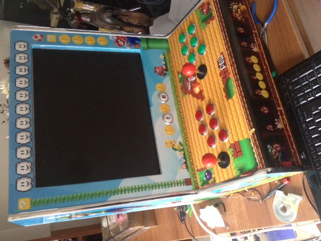

          This is what I have built so far

              Thats the arcade as it stands.
              I did know about the two select and the Hot Key buttons i need. I didnt want to add them and drill the arcade till im sure i can get this up and running.
              I know it sounds daft but once ive done my configure how do i then edit the recalbox.conf ? my issue i have is (being new ) i dont know what each button should be mapped to even if i got to the conf file. i dont know if that makes sence ? what should be A,B,X etc to work with the majority of emulators.
              Thank you again for your help.
