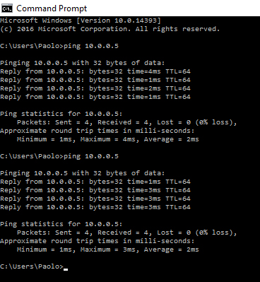

          Since I posted earlier on, this is what I've done and where I'm currently at. I connected my Pi3 directly to my router using an ethernet cable and updated the RecalBox system to the latest one. I then was able to go into the network settings and see that the status is 'connected' and that my IP address is '10.0.0.5'
          Now this is the first time I've done a ping test so I had to google how to do that, sorry.
          But I've now done a ping test to that IP address and this is the results. Does this look correct?0_1481081909290_Untitled-1.jpg

            Also, I've now installed WinSCP
            This is what I've entered in order for it to proceed to the next part.
            File protocol: SCP
            Host name: 10.0.0.5
            Port Number: 22
            Username: root
            Password: recalboxroot
            It then proceeds to a dialog box and asks for a password which again I entered recalboxroot. It then asked if I wanted to proceed with the connection etc which I clicked yes. I will now try to copy a rom into a folder and let you know if this works 🙂
            And now I can see a page similar to your second photo. I will try to copy a rom to a folder

              It appears to be working and I've successfully transferred 6 PSX roms and all of them work.. Very appreciative of your post and that definitely helped me out a lot as I was using different username's, passwords, and despite downloading a bunch of things I didn't come accross the one you mentioned so I'm glad you suggested that as it seems very simple to use 🙂
              Thank you very much and all the best. Now I just have to figure out how to add a image to the game so when I hover over it, it'll show a picture like the other roms. But I'm guessing that shouldn't be too hard 🙂
