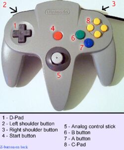

            Hello @JumpingJack88
            Do you map your controller in Emulationstation Menu > Options gamepad ?
            You need to map, D-pad on D-pad and Analogy Control stick on joystick.
