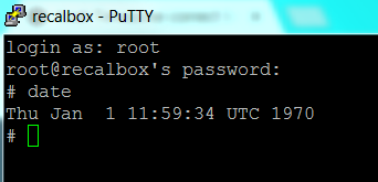

        what does date show in shell ? the right time ?
        chewunit 2 Replies Last reply Reply Quote 0
        • chewunit
          chewunit @Substring last edited by
          @subs !
          • chewunit
            @subs
              Ntp is not working. Period 😛
