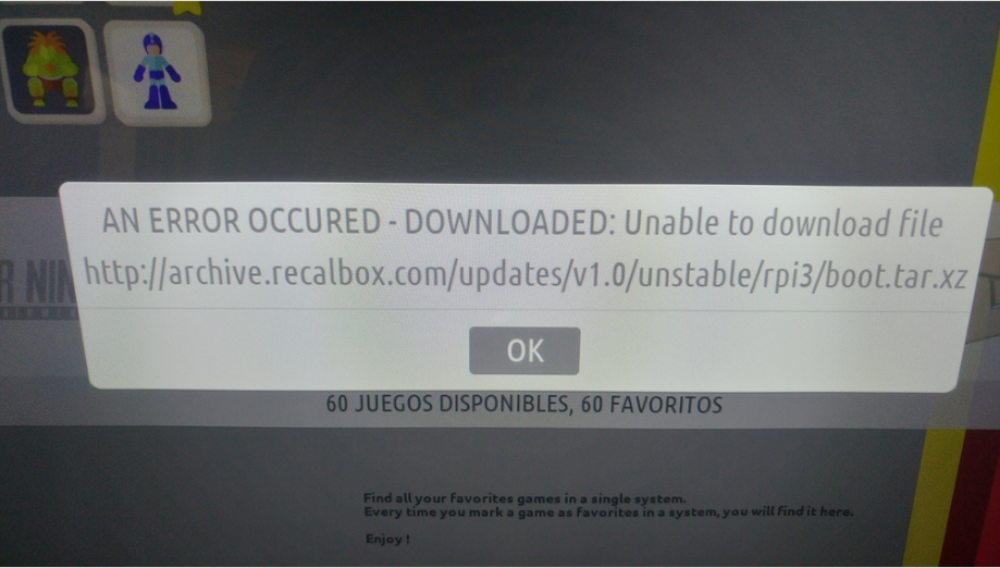

                                Hi again @azvarel @Substring
                                I can't update to 4.1, i change the source to unstable but i can't finish the update.
                                I get this error:
                                  Substring @cagiraudo last edited by
                                  @cagiraudo try again until it succeeds

                                    • cagiraudo
                                      @Substring i tried 10 times yesterday and the same error.
                                      Maybe i can't back to the unstable becouse i am in a branch?? Or something else, but i can't update again
                                        @cagiraudo no you can switch back to unstable (and not gitlab/unstable). I manually tried to download ths file, had no problems.
