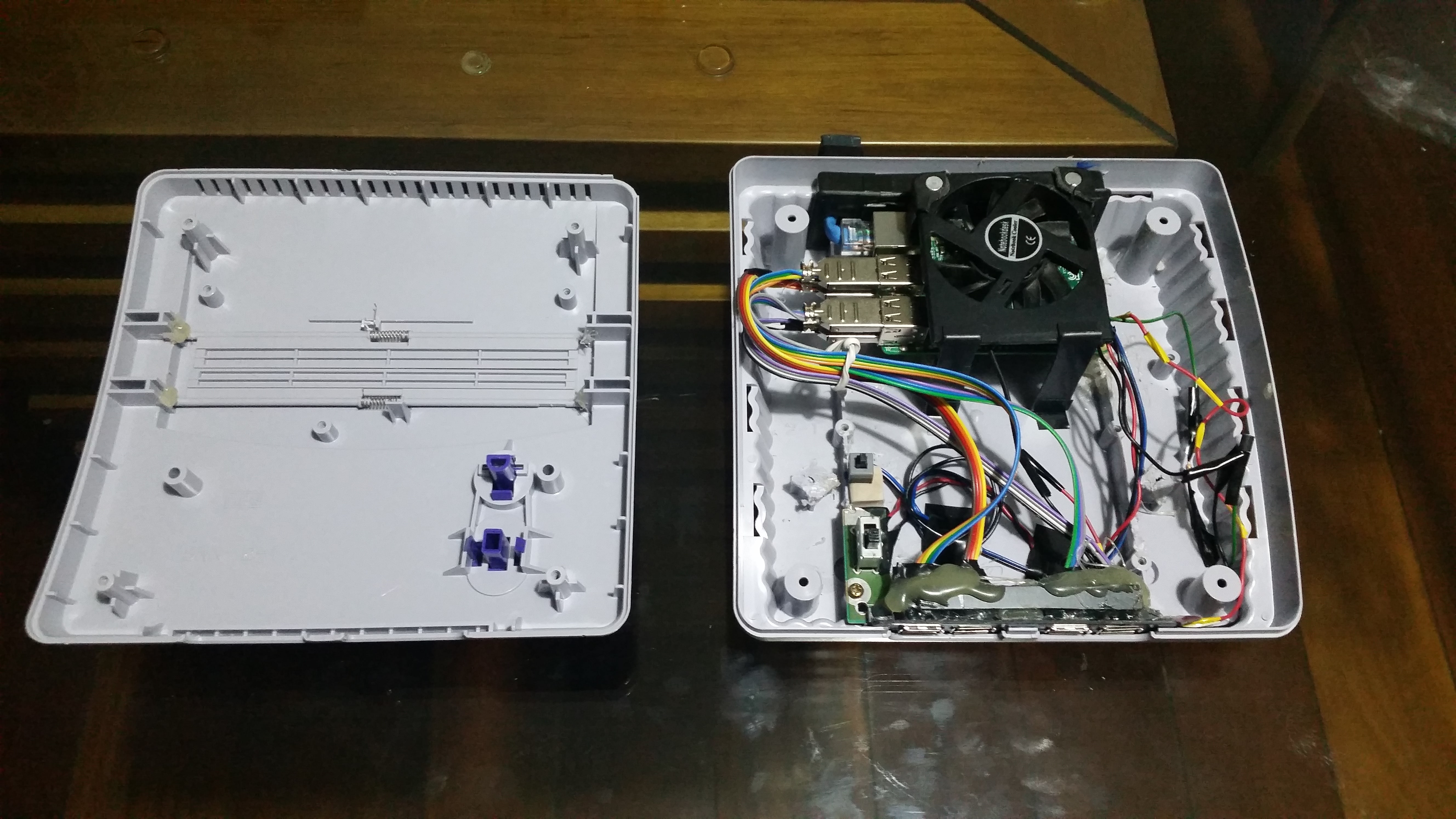

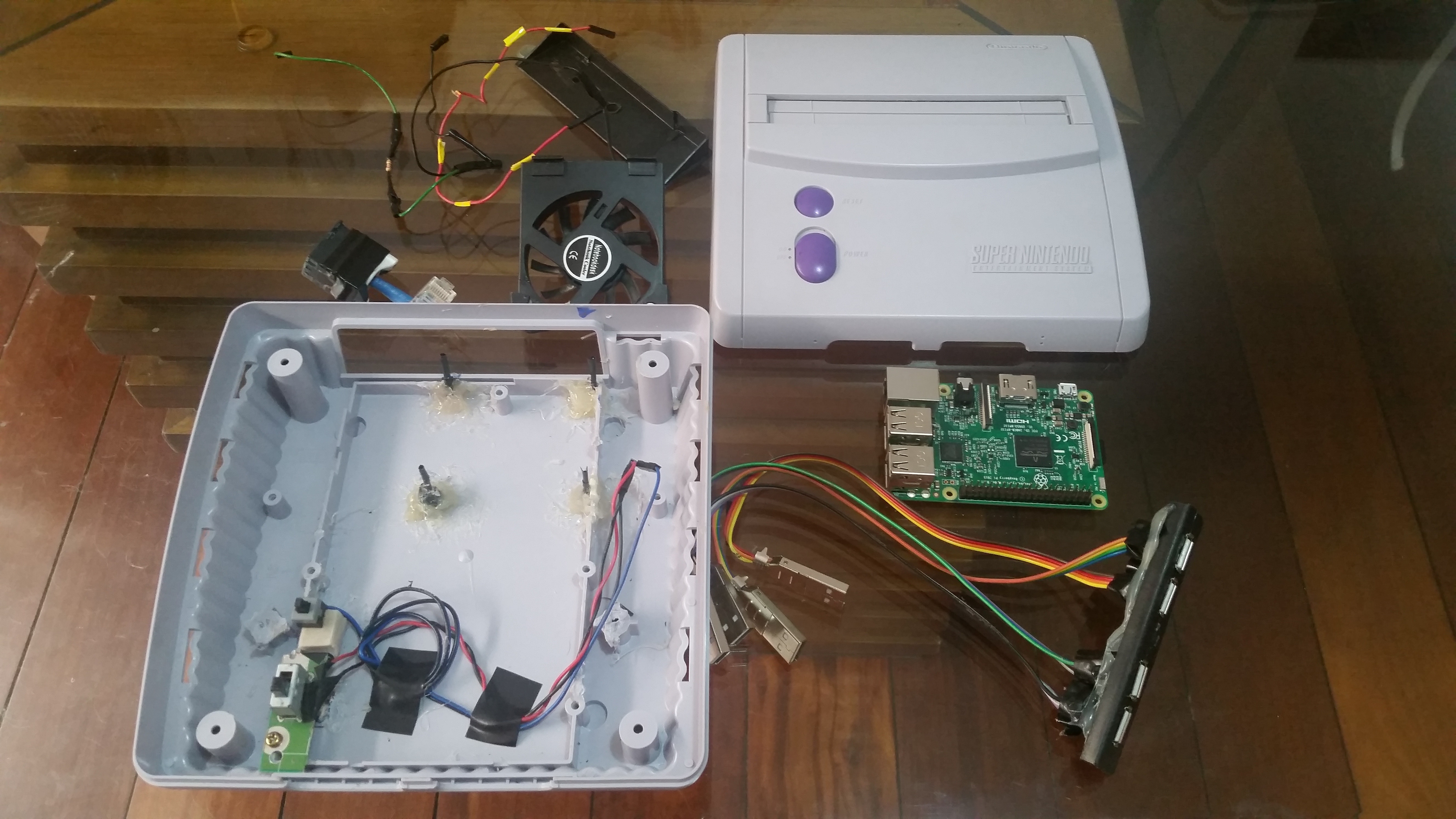

      After spending a few days, learning many new things, finally my first project is finished!
      A SNES mod named "SNES BaPi" powered by a Rapsberry Pi 3 + Recalbox.
      I used:
      • 1 SNES "baby" case;
      • 4 handmade USB extension cables;
      • 1 handmade Ethernet extension cable;
      • 1 momentary switch from an old PC;
      • 1 on/off switch from snes board;
      • 1 fan from an old from an old cooling pad;
      • 1 Resistor 330 ohms;
      • 1 Transistor BC337;
      • 4 roofing nails;
      • 1 DVD case;
      • hot melt glue;
      • super glue;
      • electrical tape;
      • electrical solder.
      And here are some pictures:

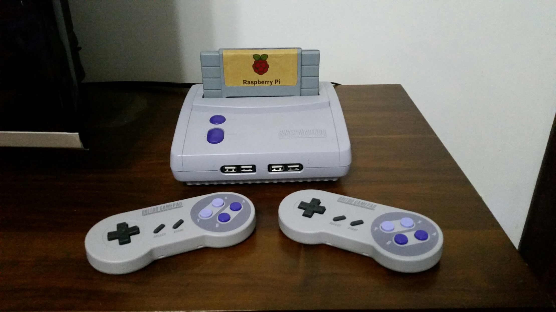

                  Finally the cartridge and the 8bitdo controllers!
