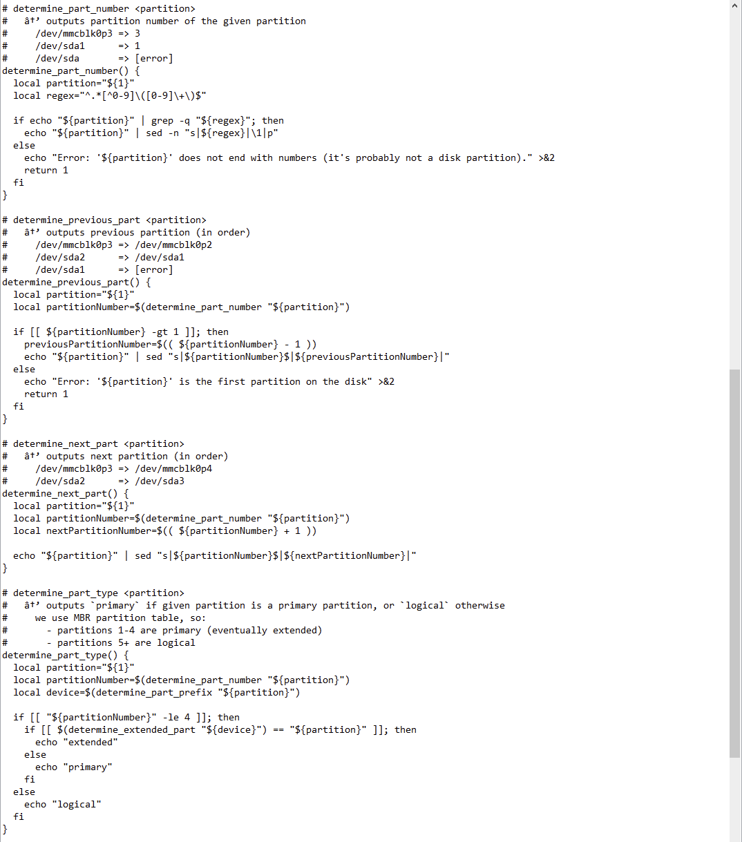

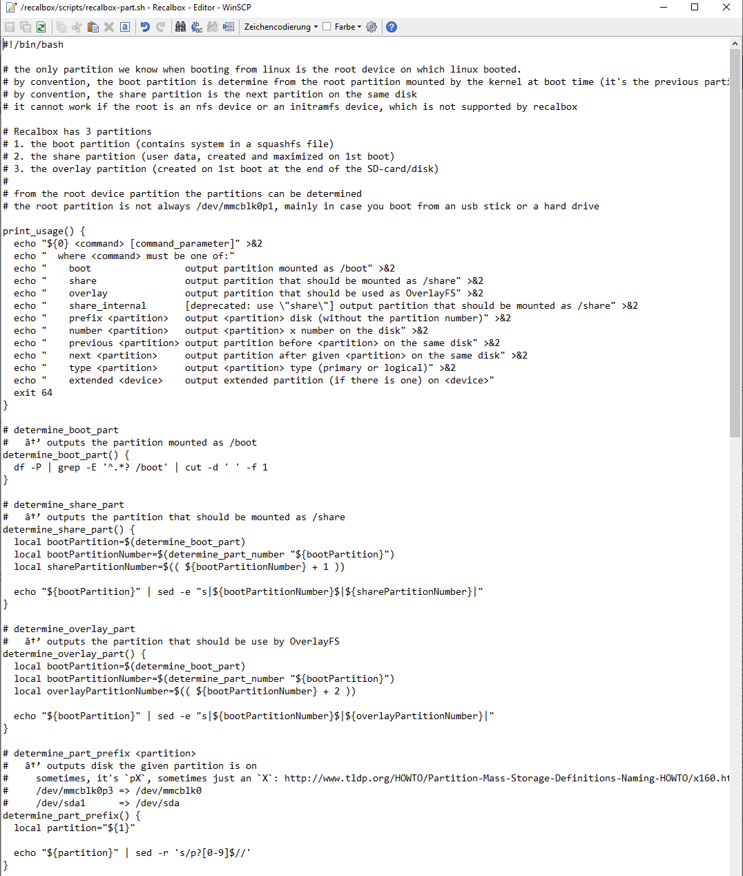

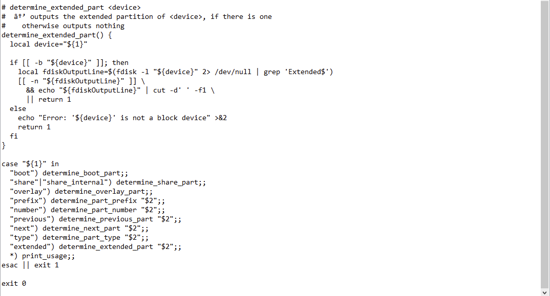

                      Finally, here in /recalbox/scripts/recalbox-part.sh i don`t know if everything is ok.
                      Enfin, ici dans /recalbox/scripts/recalbox-part.sh je ne sais pas si tout va bien.

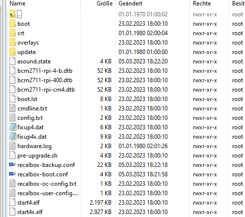

                          What i did first: Only an update from 8.1.1 to 9.0. After that: No bootvideo (own and built-in).
                          Then i checked everything:
                          recalbox-config and every file which could cause the issue here:
                          Then I took off the SSD and tried just going through the SD...again, no boot video.
                          Then I did a fresh installation on the SD Card (with 9.0 image) and started first without SSD. Not even the Recalbox videos are played (I've booted several times and of course checked the config. here beforehand).
                          Then I reconnected the SSD and I now have my system as it was. However, still without boot videos.
                          digitaLumberjack 1 Reply Last reply Reply Quote 0
