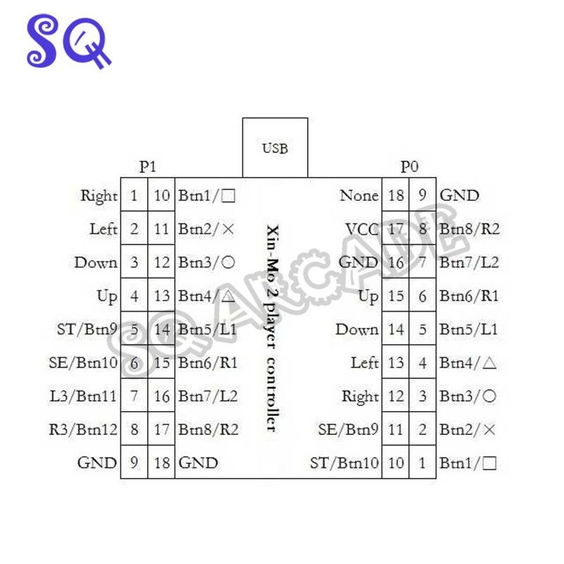

      I solved it fully ! 💪
      I have redone the wiring using the attached schema.
      After that, in the menu confirmed the mapping for player 1 and player 2.
      I assigned Hot Key for player 1 to L2, and R2 for player 2.
      After that it worked well, except the player 1 and 2 were swapped for an unknown reason, and even in the paf conf menu it changed nothing (a bug?).
      to solve it I modified the recalbox.conf from:
      emulationstation.pad1=03000000c0160000e105000001010000:Xin-Mo Dual Arcade
      emulationstation.pad0=03000000c0160000e105000001010000:Xin-Mo Dual Arcade
      to:
      that is it. hope it will help others that me.

    • issue with Xin-Mo 18 pin on Recalbox 9.0
      Hi all,
      Had a bartop with hyperspin on a pc that died recently. Then replacing it by recalbox 9.0 on another pc (minisforum um350).
      But i'm really struggling with controls.
      i followed carefully the wiring like defined here:
      lhttps://wiki.recalbox.com/en/tutorials/controllers/usb-encoders/xin-mo-controllers-configuration
      Currently in menu i'm able to move and use buttons with both left (P1) and right (P2) part of the arcade panel (except hotkey).
      in game, the left part of the panel seems not to work and the right part of the panel works (still except hotkey), but with a trick: in game left part controls the P1 instead of player 2.
      i did my search before crying for help. and my issue is similar to https://forum.recalbox.com/topic/28390/probl%C3%A8me-insoluble-inversion-p1-p2-encodeur-xin-mo?_=1677682351138
      but the solution doesn't convince me as we can't swap the 2 usb, as there is only one :).
      it is a xin-mo dual arcade xm-02 with 18 pin for each player, but only 1 usb connection.
      also looked at other thread like this one:
      https://forum.recalbox.com/topic/21844/recalbox-7-01-pb-encodeur-xin-mo/17
      but I'm puzzled on the way to go as some steps contradict the documentation:
      post that advice to configure 2 players, where the wiki says specifically to configure only 1
