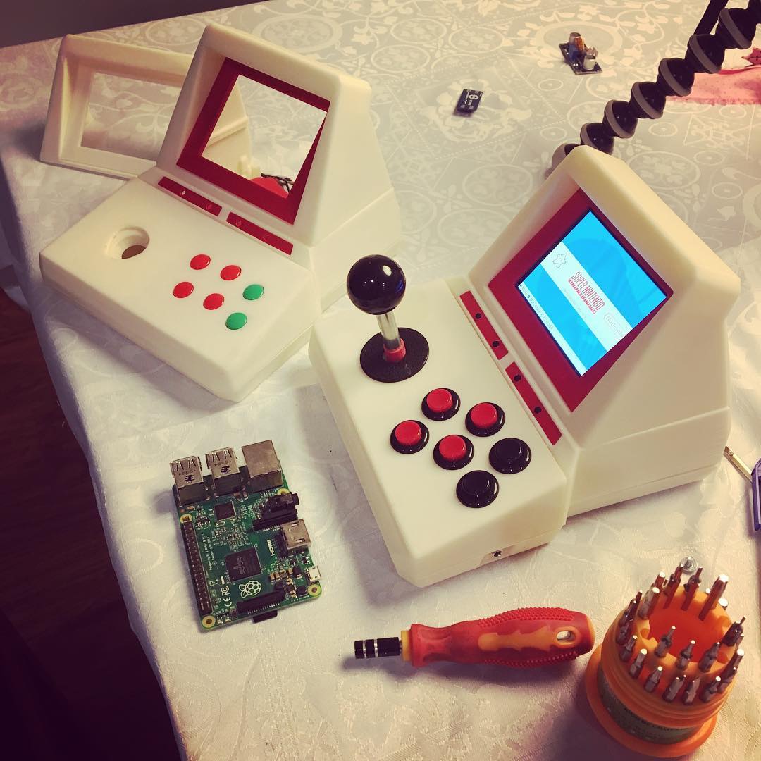

I would like to present my new project. My 3D Printed tiny recalbox Arcade. with sanwa control, 3.5 screen (composite), sound, batteries, etc. Hope you guys like it !
(The shaft will be replaced by a shorter one soon).
I can´t wait for Recalbox 4.1 so the project will be "more" complete.
And i have a question...Is it possible to have composite video working and auto-change to HDMI output when using the hdmi output ? My Romni arcade has a hdmi extension on the back, but when i plug it, the hdmi only show the first colored box on Pi boot then it goes to the composite... I followed the tutorials to have composite output, and maybe they FORCE the composite output... But i would like to be able to use the internal screen and the external monitor (hdmi). NOT at the same time of course...
Is that possible ?!
This is my first post on this forum. Glad to be here. :) Thanks !

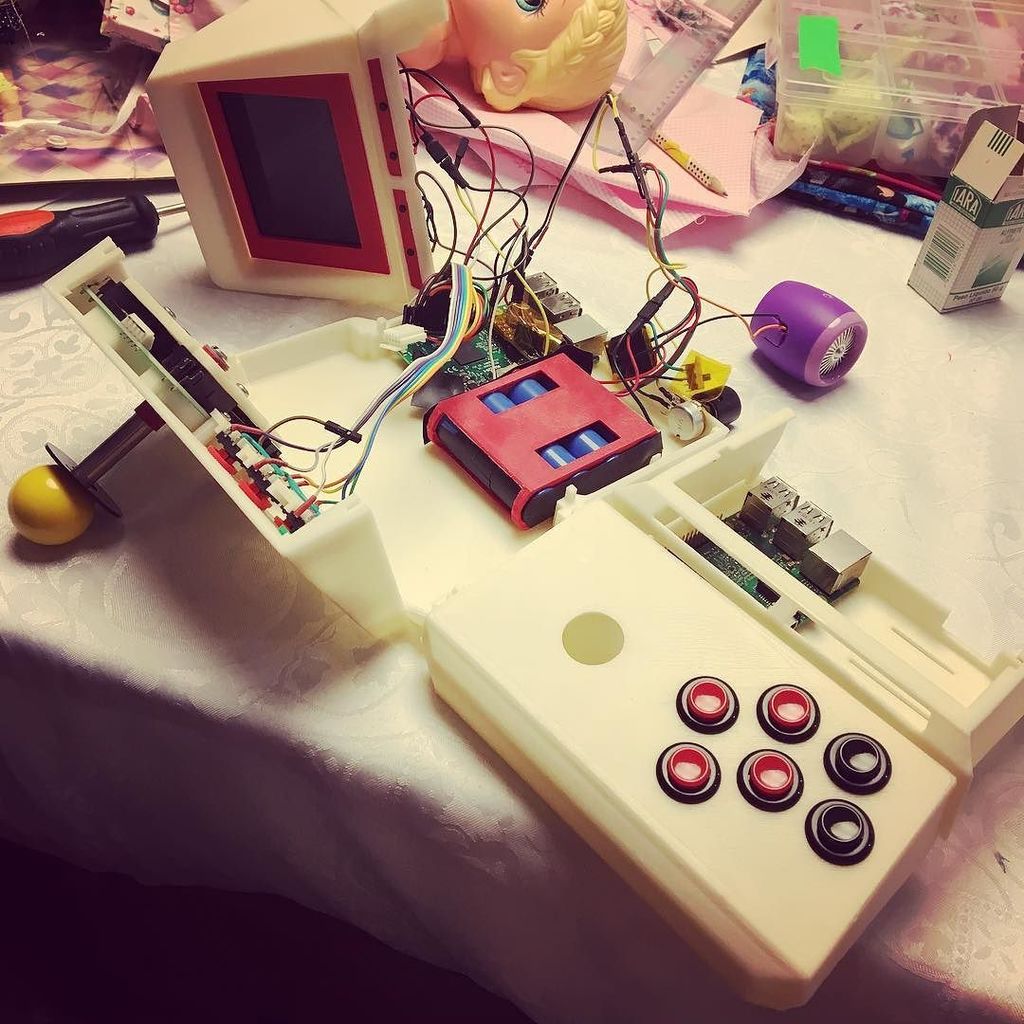

More Pics !

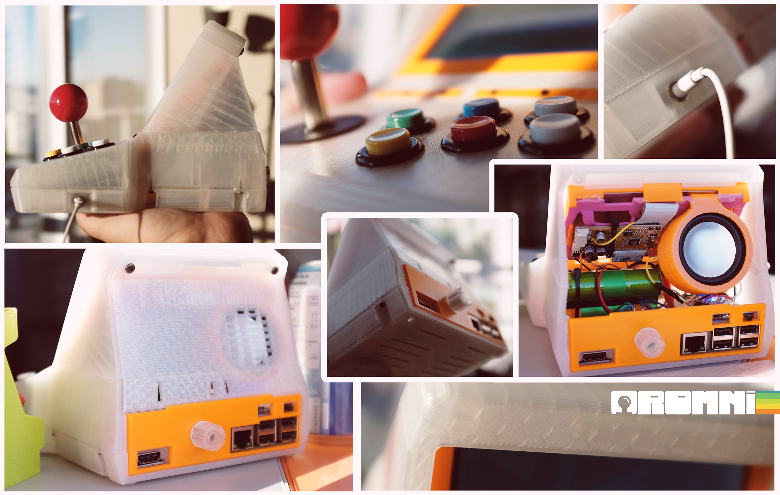

BTW this project is not 100% finished on it´s design. It´s the Prototype #6 (6 case printed until now). So there´s some minor updates/differences between some pics.
This is the prototype #6 :

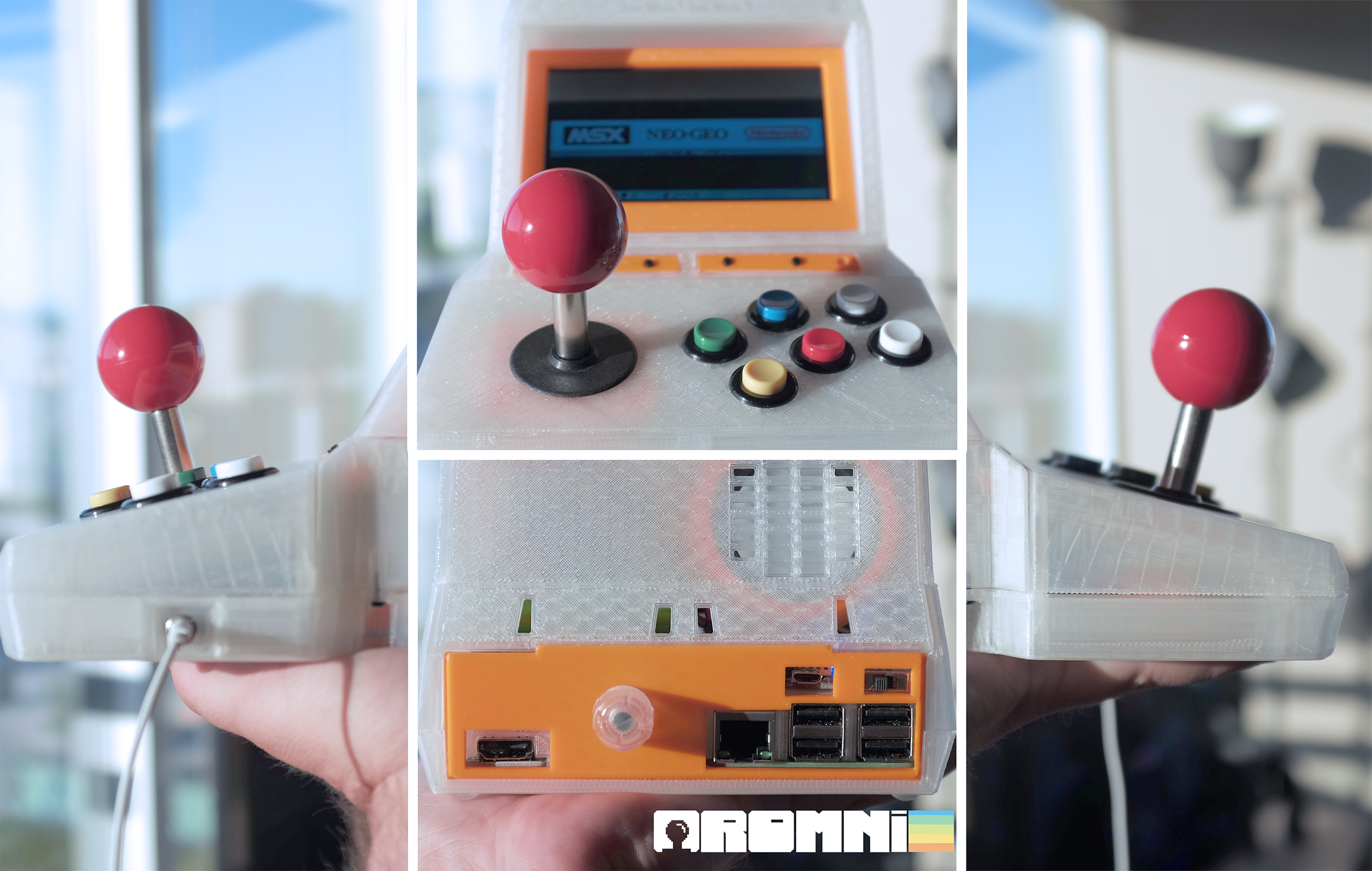

Some shots of the new Back with removable plate, so, i can use any different board, and have a more futureproof design. I just need to reprint the red plate to fit a new configuration for the board ports.
A shot of the front control pannel. With Power ON/Off button, Hotkey, Select and Start buttons.
