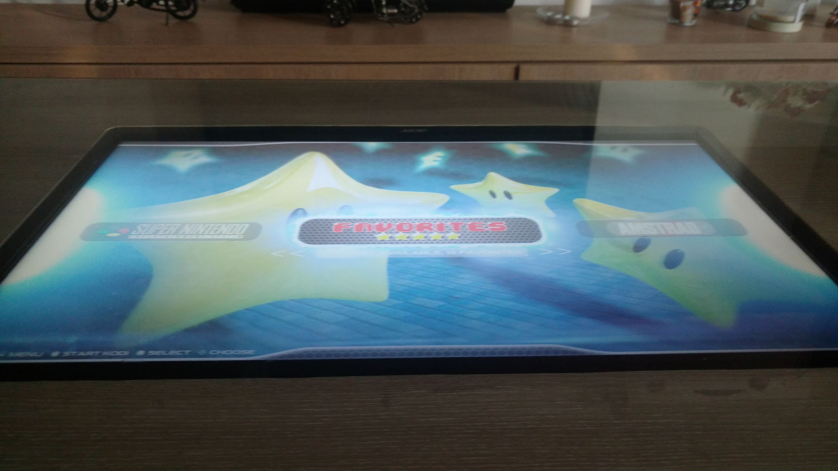

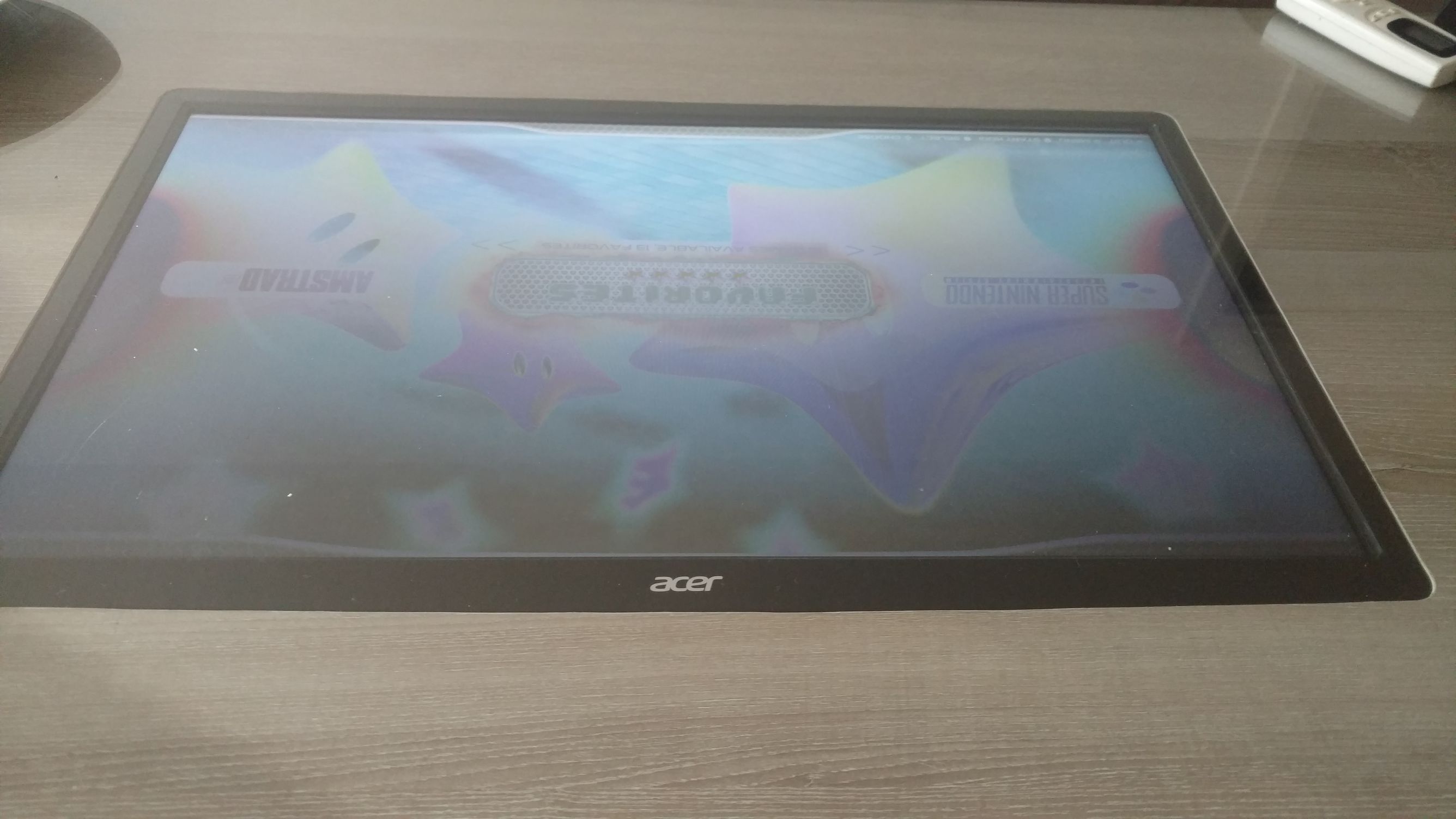

Maybe others are having the same problem so i will exemplify my reason.Looks like my monitor is not angle view
TOP VIEW
Normal view
Rotated 180
Rotate view was the only solution beside changing the monitor.
Yes, that was my 1st challenge.I didn't know that you can not see on that angle on LCD.Looks like if you rotate it you get a better view in small angles.
