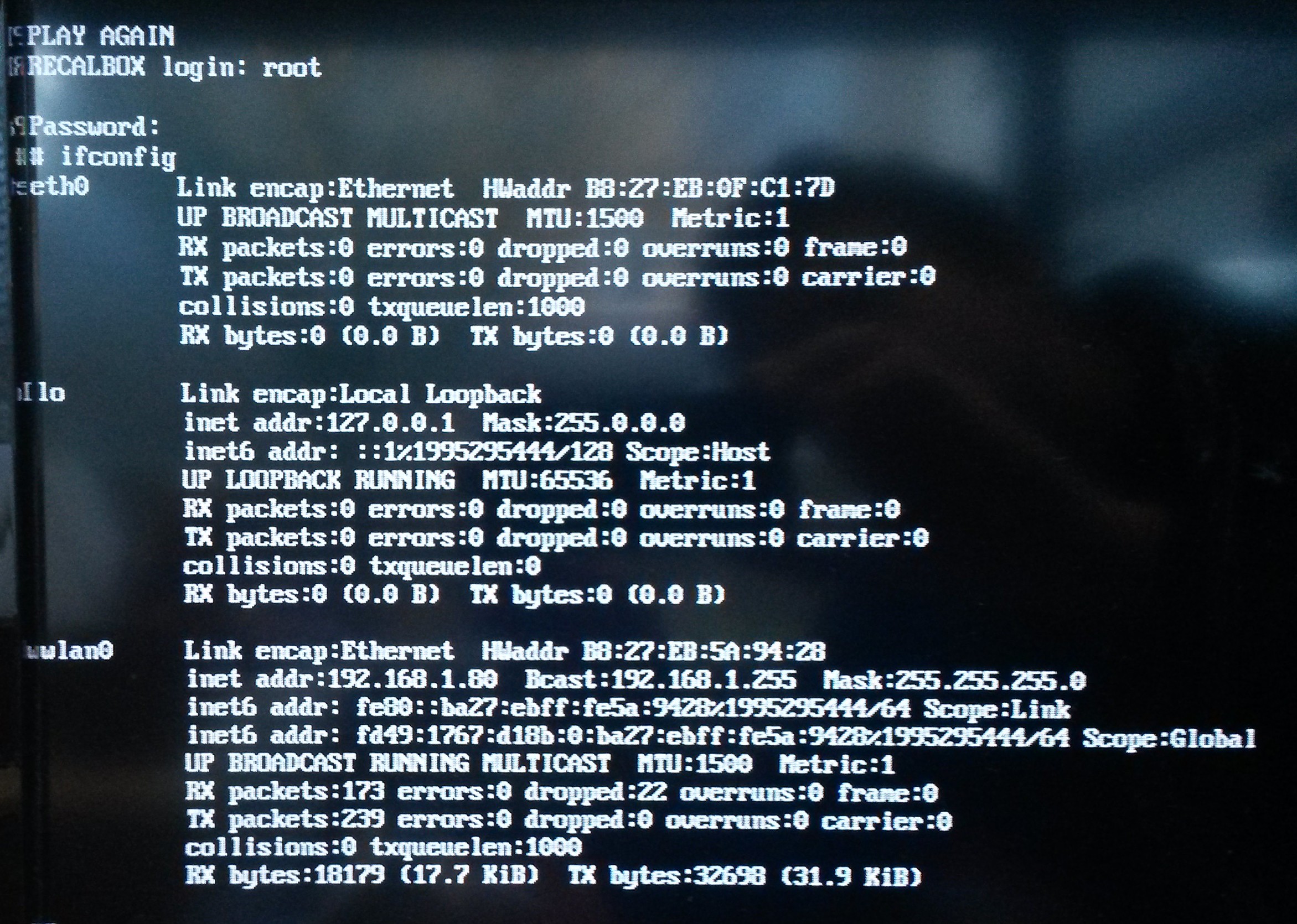

                  @hanker Can you paste the result from iifconfig ? Do you have the same problem if you plug on ethernet ?
                  • hanker
                    hanker last edited by
                    Sorry, I'm quite busy right now.
                    Here's a screenshot of ifconfig:
                    I will test connecting via LAN cable next year. 😉

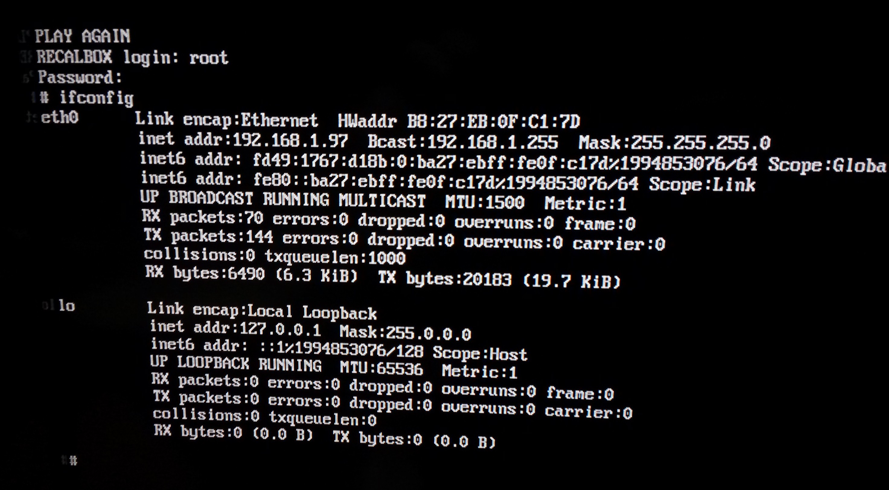

                      Hello and happy new year!
                      I just plugged in a LAN-cable, deactivated WLAN, rebooted to be sure - and everything works fine. No pinging necessary.
                      ifconfig output:
                      But I still have no idea, why remote access doesn't work when using WLAN...
                      Confused greetings from Germany
                      René
