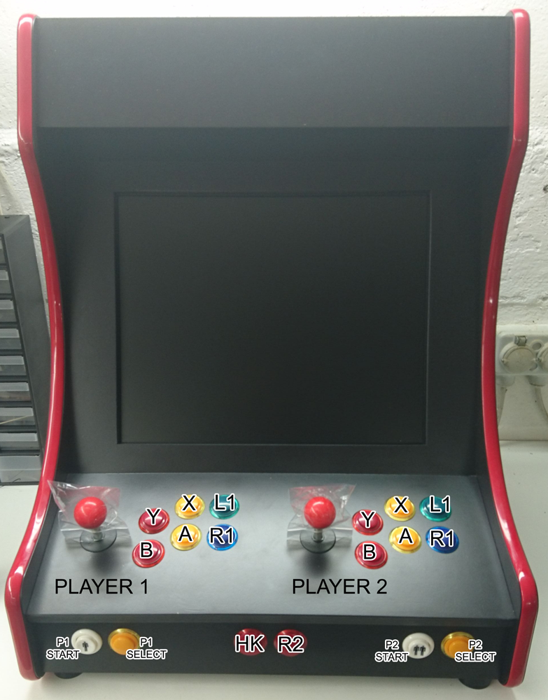

              Why don't you guys just go for one more button in the front? Like I did. I know it does not help the script problem, but the usability is great and it's very easy to achieve.

                  Substring @Nachtgarm last edited by
                  @Nachtgarm i wonder why there are condoms on your sticks ... Dude, you sure you're doing fine ? 😄

                          Nachtgarm @Substring last edited by
                          @subs These are not my sticks. It was a cabinet I sold to a customer and therefore I kept the handles untouched and shiny 🙂
                            @Nachtgarm yeah yeah ... you pervert ... 😄 lol
                            • Nachtgarm
                              @subs You have NO idea 3:-)
