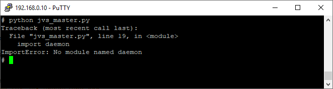

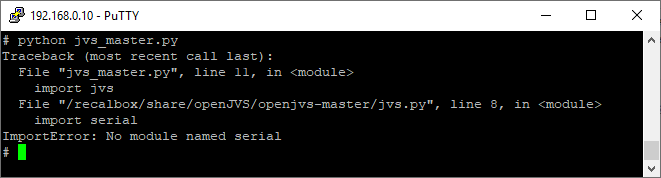

                Sur la dernière image de recalbox que j'ai téléchargé (6.0-DragonBlaze), c'est lib ne semble pas présentes oO:
                Quelqu'un aurait une idée?

                    Daemon and serial seem alrady present on the buildroot package but python doesn't find it on the official prebuild image.
                    So I have a question:
                    If packages are not declared in configs/recalbox-odroidux4_defconfig, they will not be present as python module after build/install?
                    • paradadf
                      paradadf Staff @delferius last edited by
                      @delferius yes. You should activate them in deconfig.
