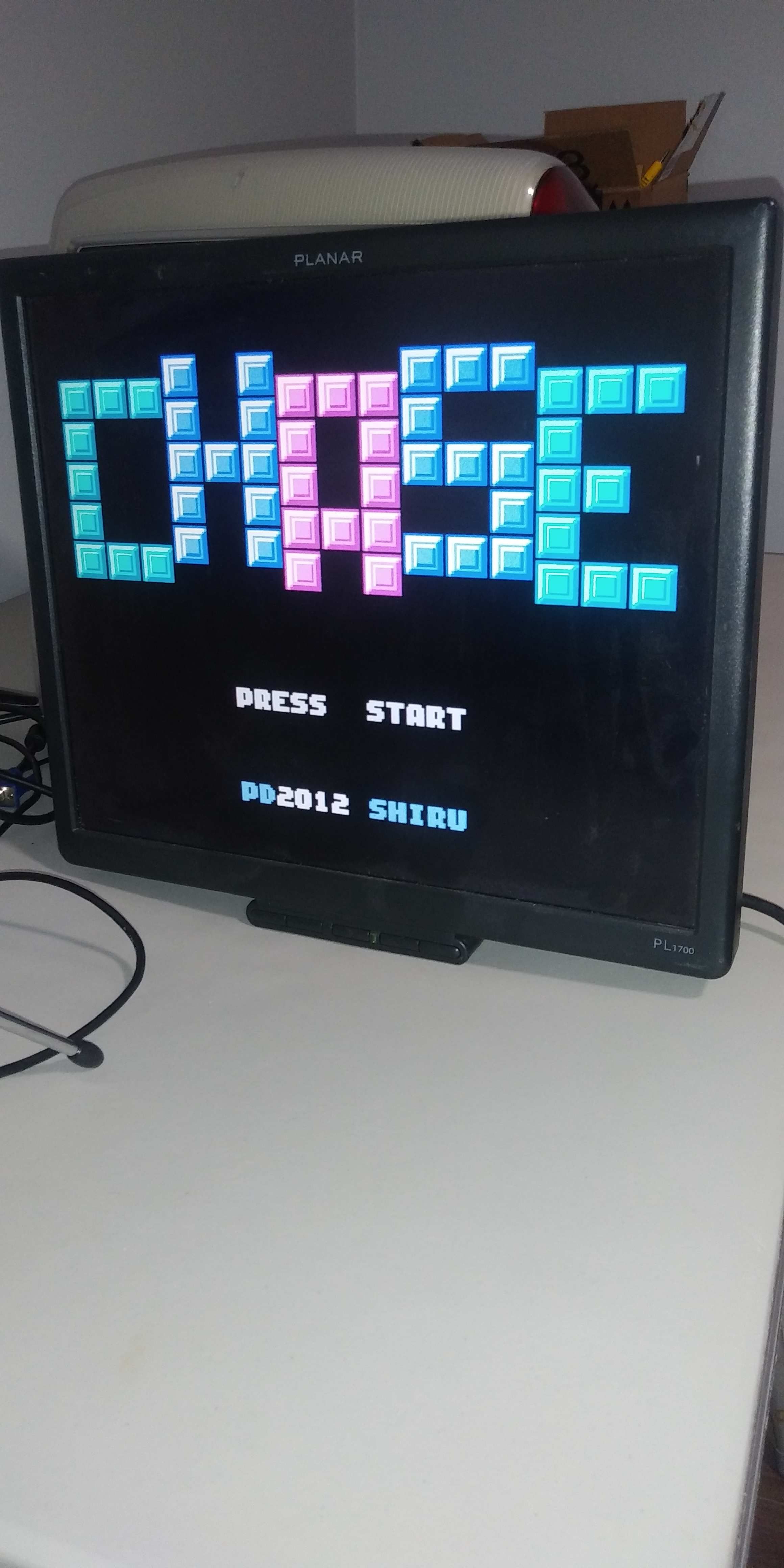

                  I tested with a different monitor as you suggested with the following config.
                  global.videomode=default
                  I also commented the following in config.txt
                  #hdmi_group=2
                  #hdmi_mode=18
                  This worked, see attached image.
                  Recalbox loads games correctly when using a raspberry pi 3.
                  see video
                  https://youtu.be/sQ73Ow83Xuo
