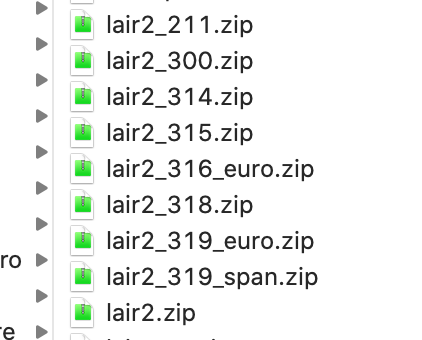

      Also I just remembered while looking at my daphna folder. I have several dlair2.zip verisons
      See screen shot
      I also found this article explaining the different versions:
      http://www.dragons-lair-project.com/tech/pages/dl2.asp
      my take is the dalir2.zip corresponds to the media files
      I seem to remember trying a few different versions of these lair2_X. I copied them to dlair2.zip and tried it
      i seem to remeber for me dlair2_211.zip copied to dlair2.zip was the one that worked for me.
      I hope this helps
