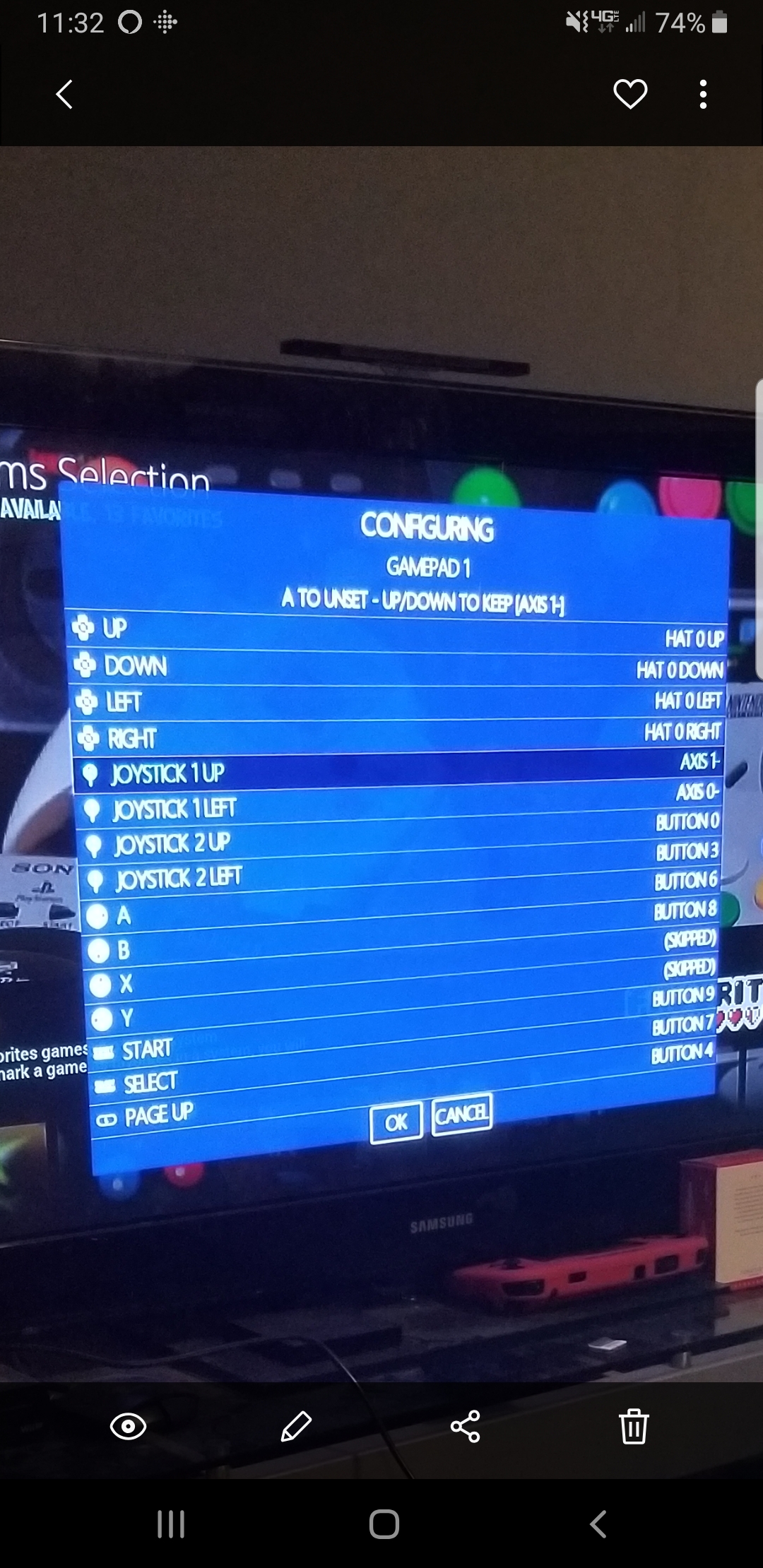

        0_1585189810298_cfd9f027-55fa-4fa9-9d84-ba7148df597c-image.png @scottie
        here is what i am seeing on the dpad
