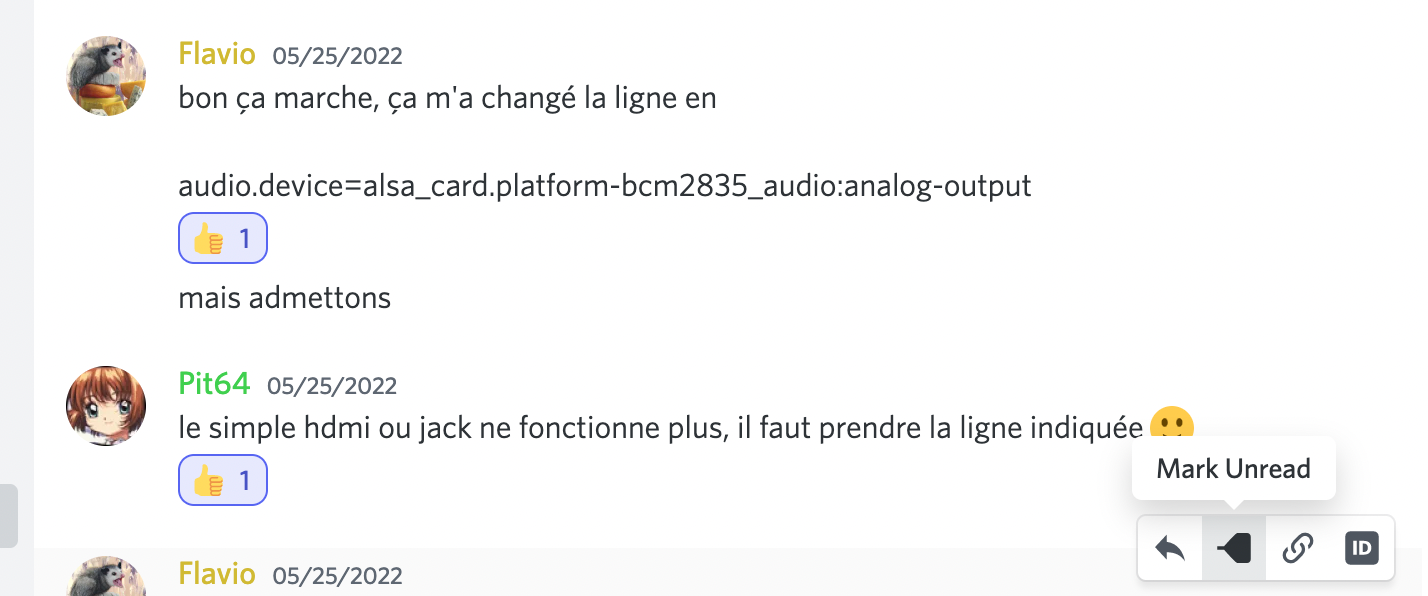

    • RE: No audio on RPi 3 + recalbox 8.1.1 + RGB Dual from 3.5 output jack
      Hey @alvin, I'm using ipac2 on USB connected to my Rpi. Recalbox recognizes the joysticks and allows to set them up on the CONTROLLERS section.
      I have turned "Force sound on jack" to off and ensured that "auto.devide=jack", but still no sound and on the log I see
      [1980/01/01 02:00:50.334] (INFO ) : [PulseAudio] Initialized.
      [1980/01/01 02:00:50.334] (INFO ) : [PulseAudio] Switching to jack
      [1980/01/01 02:00:50.334] (ERROR) : [PulseAudio] Invalid playbackname: jack
      [1980/01/01 02:00:50.335] (WARN!) : [PulseAudio] Invalid sink or card:
      In the discord server I read that "jack" was not valid anyomre, that I should use
      “audio.device=alsa_card.platform-bcm2835_audio:analog-output”
      I triede also that, but still no sound ((
      Toni
