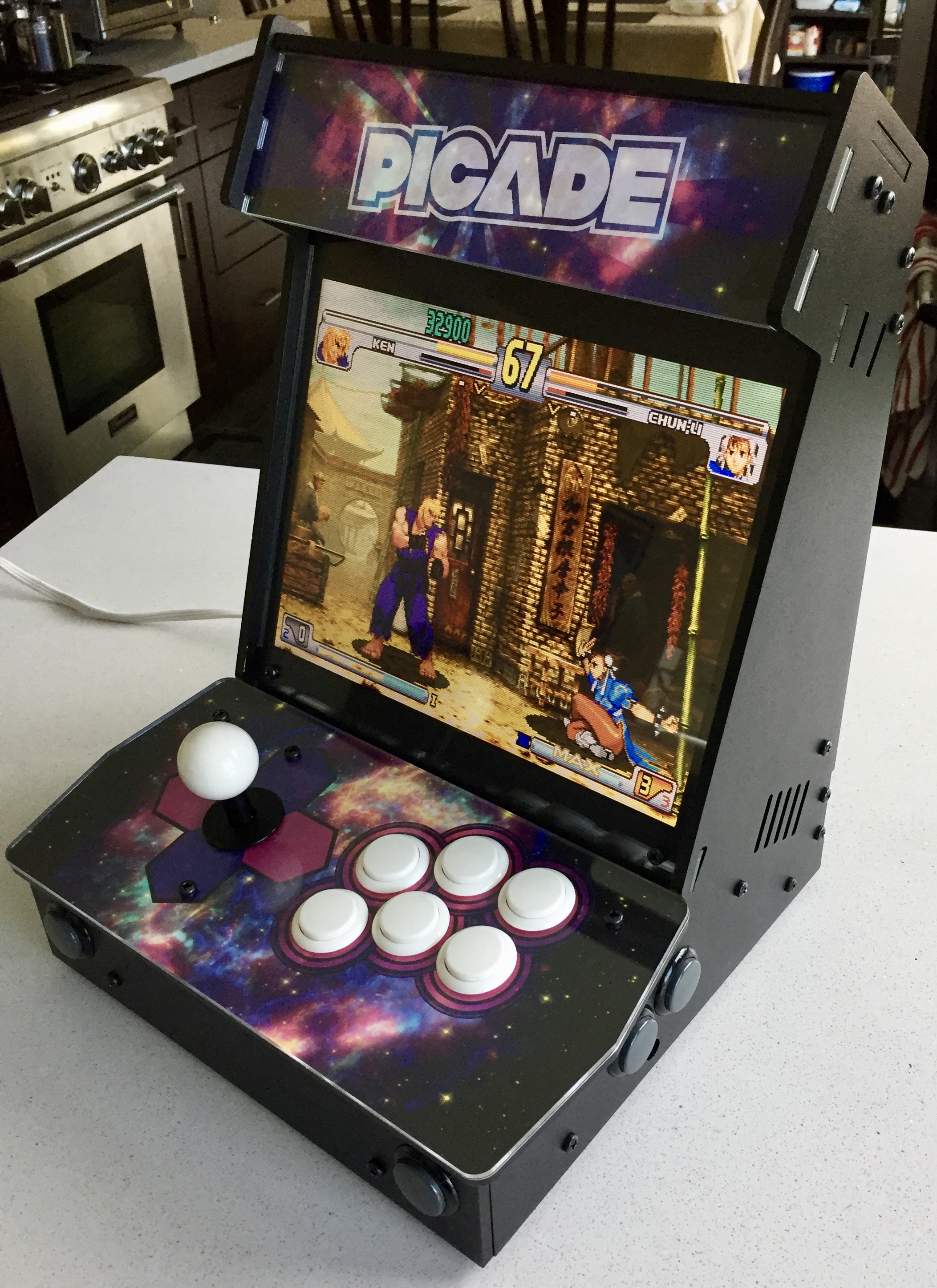

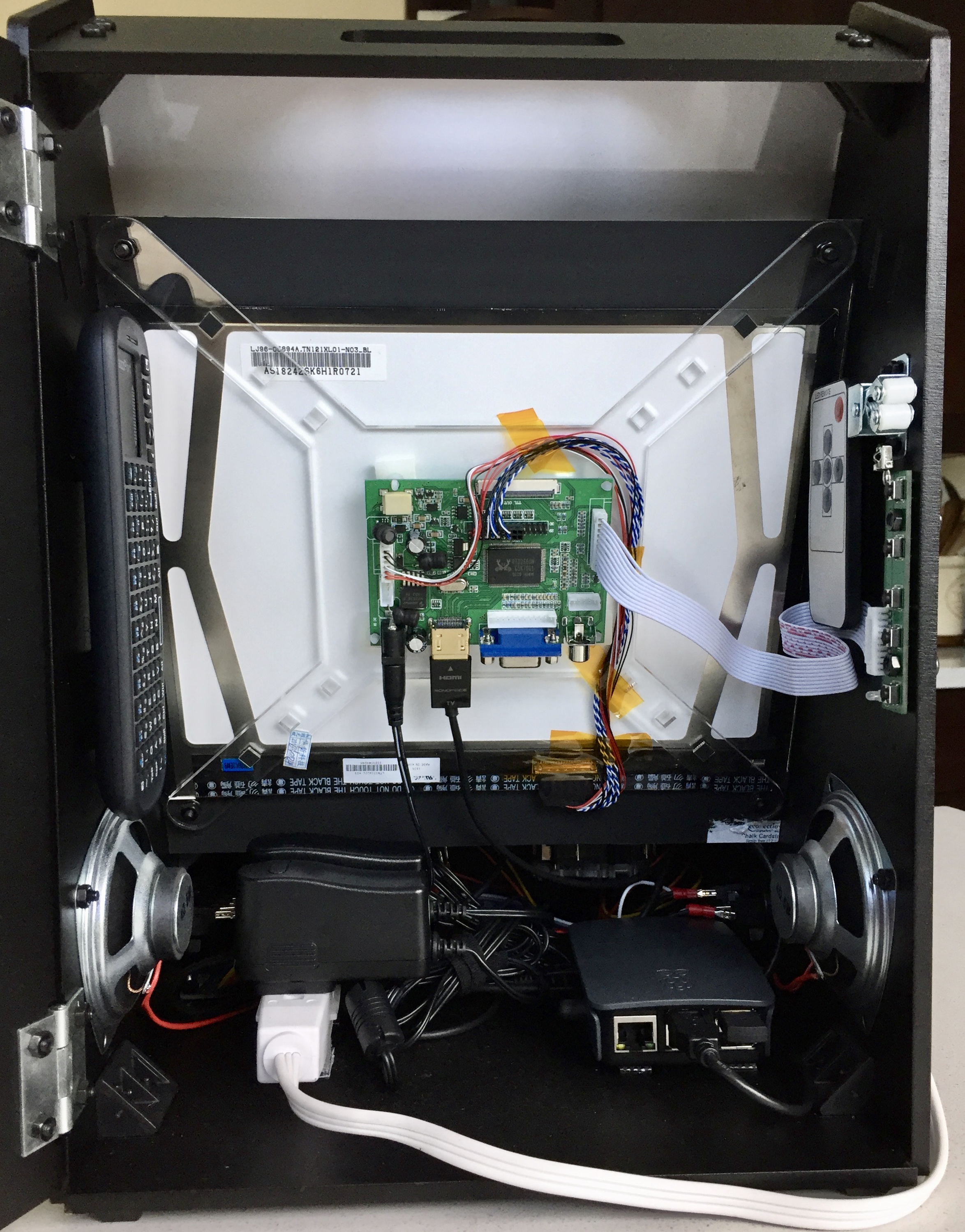

    • My Picade
      The kit came with a dinky 8" display, so I upgraded to a larger 12.1" display.
      I swapped out the crappy included Zippyy joystick and Abundant buttons for a Sanwa JLF and OBSF-30's.
      In order to get all buttons functioning properly in Recalbox, I flashed the Picade kit board with modded firmware I found on the Pimoroni forums. Now it works perfectly!
      Check it out:
