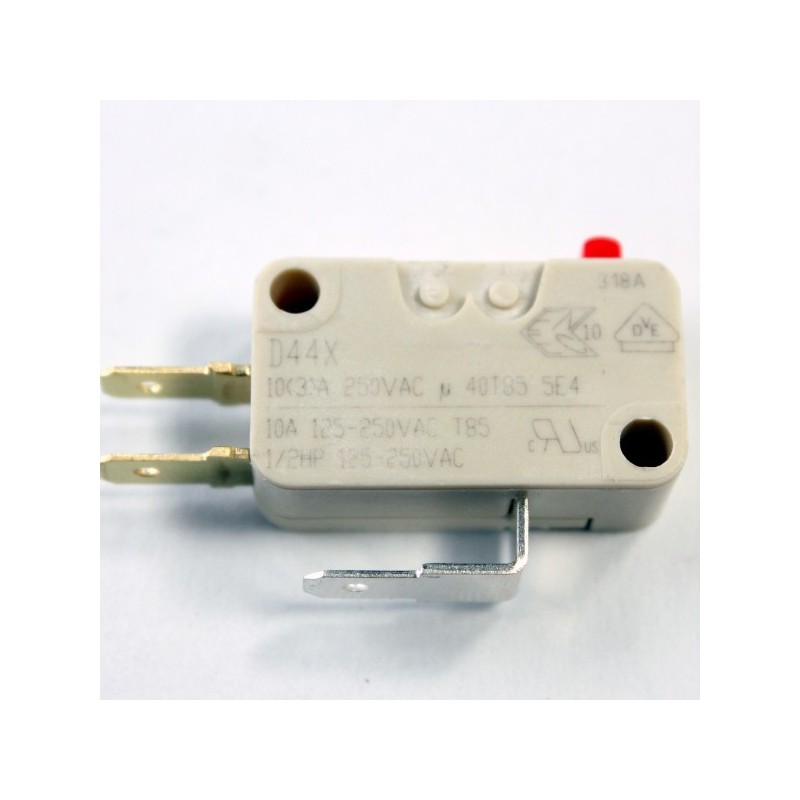

        I use D44X cherry microswitches on my buttons.
        Those microswitches have 2 possible plugs to connect to your GPIO.
        Following a tutorial I found on the internet, I connected them to the plug that is the closest to the button resulting weird behavior (like the buttons were "maintained pressed on" which led to random exit from the games as the hotkey was considered maintained ==> like 2 buttons pushed at the same time.).
        I changed the connection to the plug that is the closest to the Ground plug and it solved my issue.
