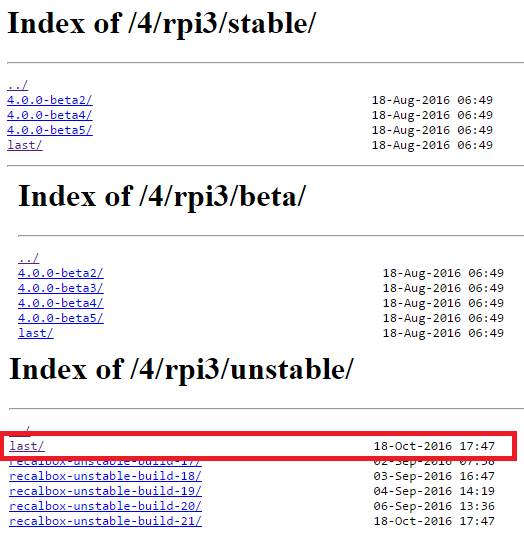

            • torra87
              torra87 last edited by
              I'm pretty sure i have updates.type=stable in config, but i'm not 100% sure.
              If updates.type is stable, maybe the updater have some bug.
              Look at this:

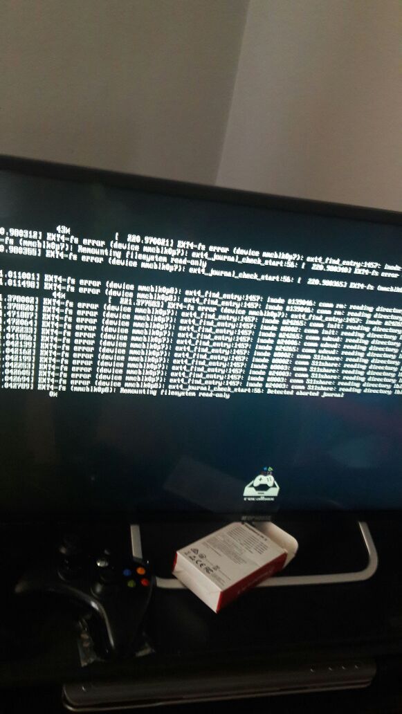

              I checked with my friend and he cant update too.
              Thanks!
              • torra87
                This is his picture:
                  Substring last edited by Substring
                  @torra87
                  if it had a bug, i think we would already know it, as the beta5 is out for 2 months already 🙂
                  the messages say that your SD is corrupted : mmcblk0p7 is remounted as read only. How can it make the update then ?

                  • torra87
                    Its not the beta5 what im updating, its beta 2 or 3 (build 53) that is failing. Now im sure that update.type is in stable.
                    Remember something, before that unstable update i could update from build 53 to 172 (beta 5) without issues. After that it started failing.
                    • torra87
                      torra87 @Substring last edited by
                      @subs it got corrupted after the update 😢
                      Nevermind, i will start from a fresh beta 5.
                        Substring @torra87 last edited by
                        @torra87 the file system is corrupted, maybe not the sd card itself. If you have a computer running linux, you can run fsck on it
