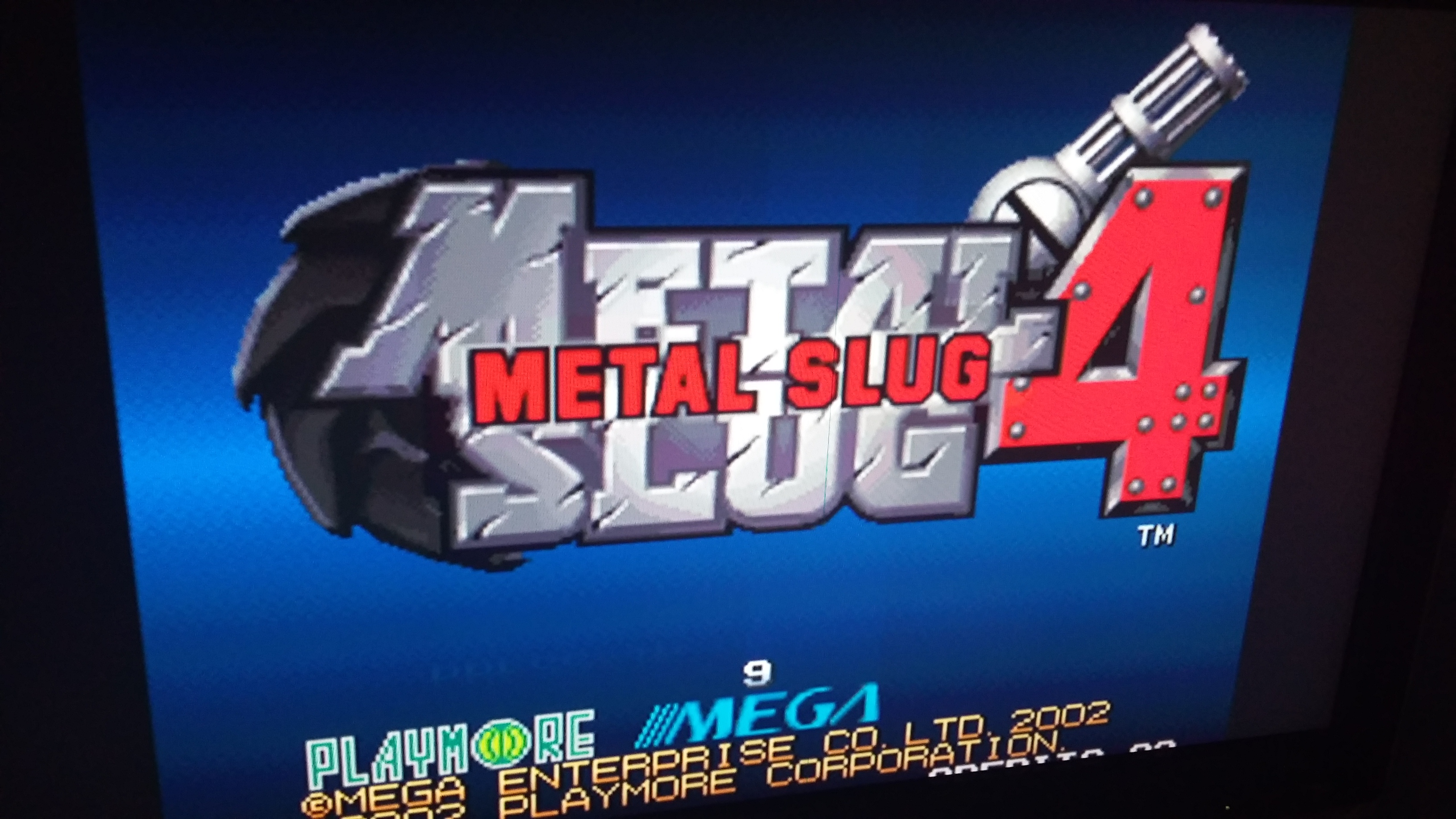

                        • Lulu XIssix
                          Lulu XIssix @cazeysan last edited by Lulu XIssix
                          @cazeysan Merci beaucoup Cazeysan, ça marche!0_1472733990713_20160901_144449.jpg
