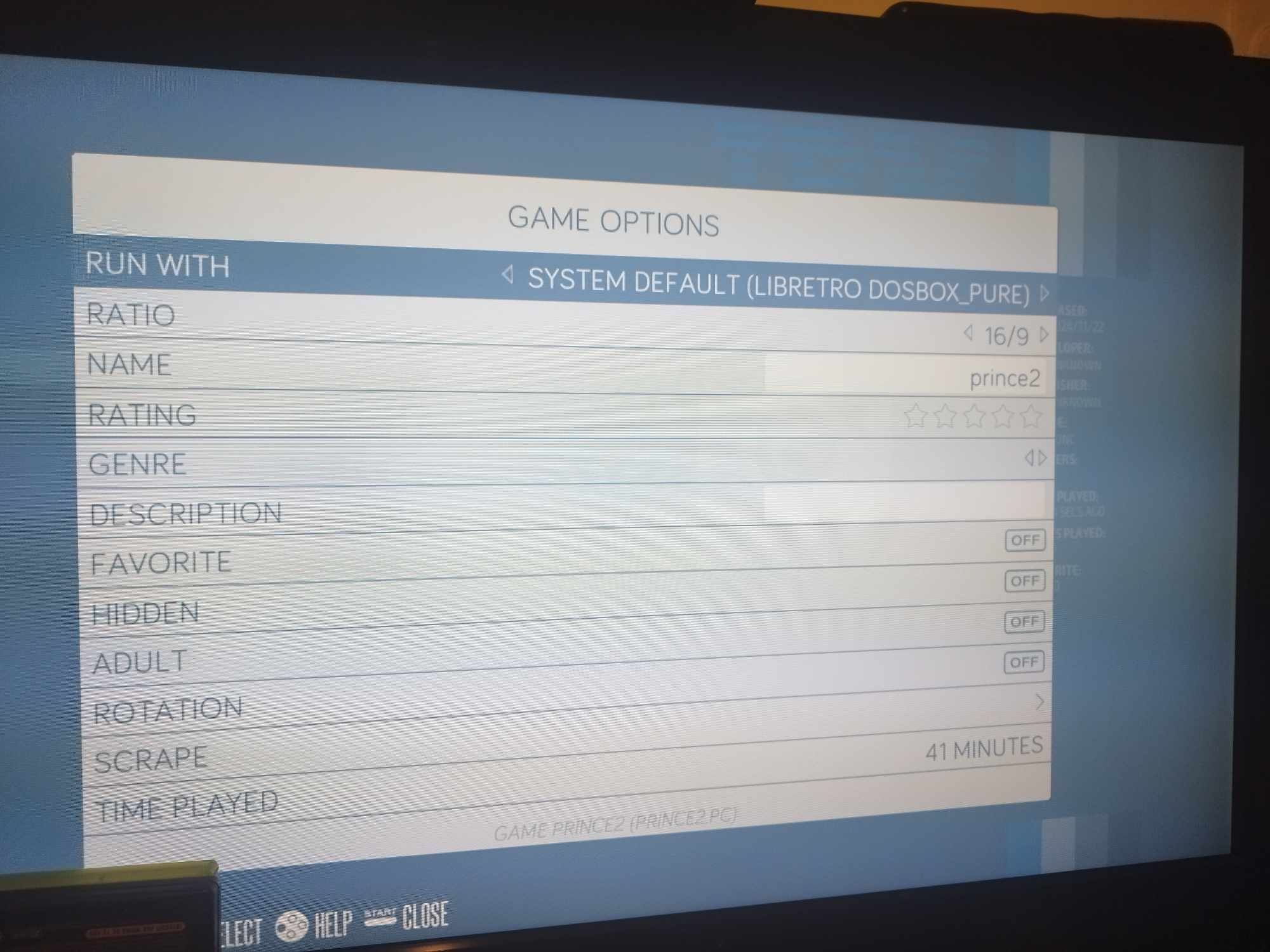

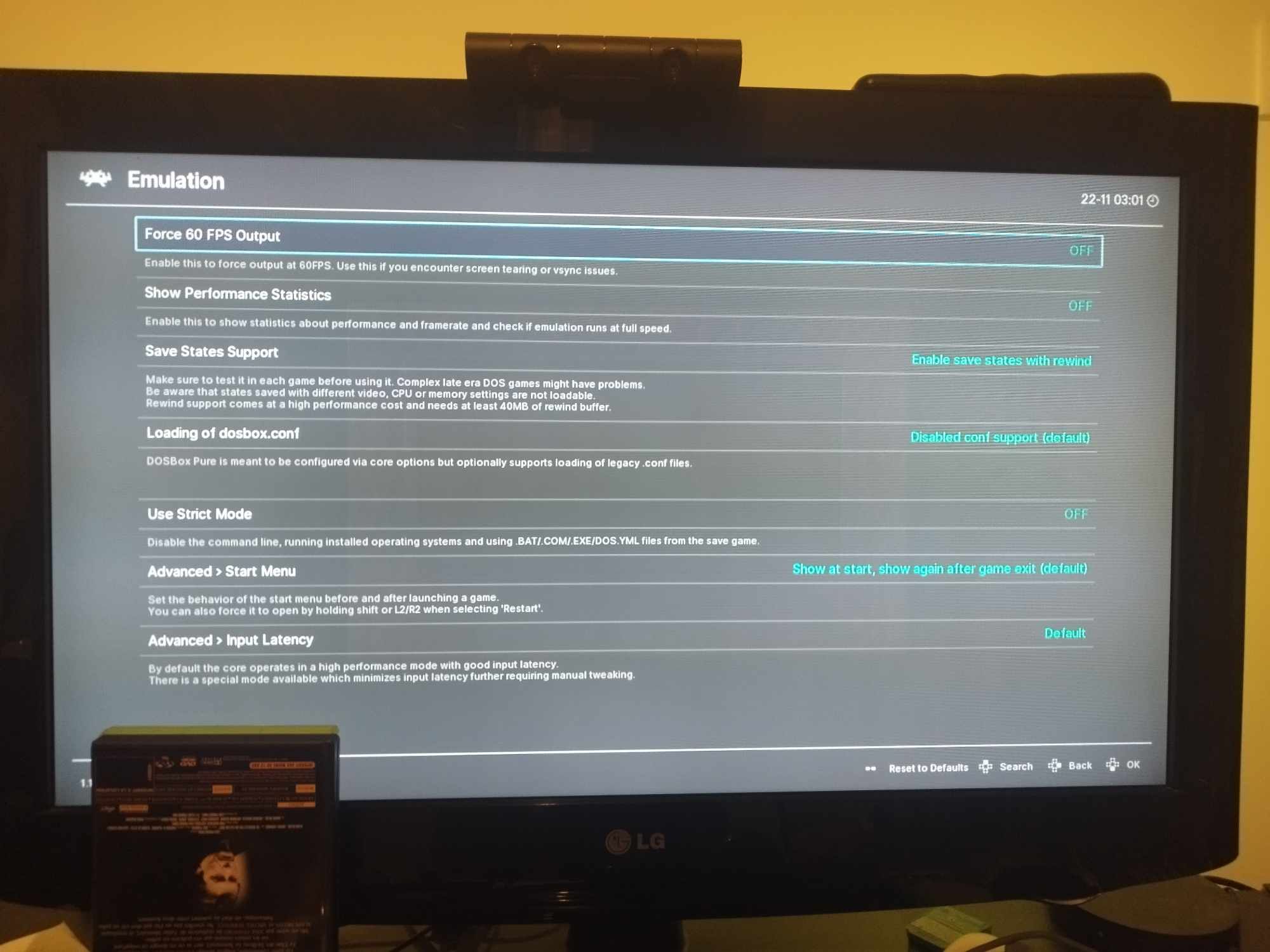

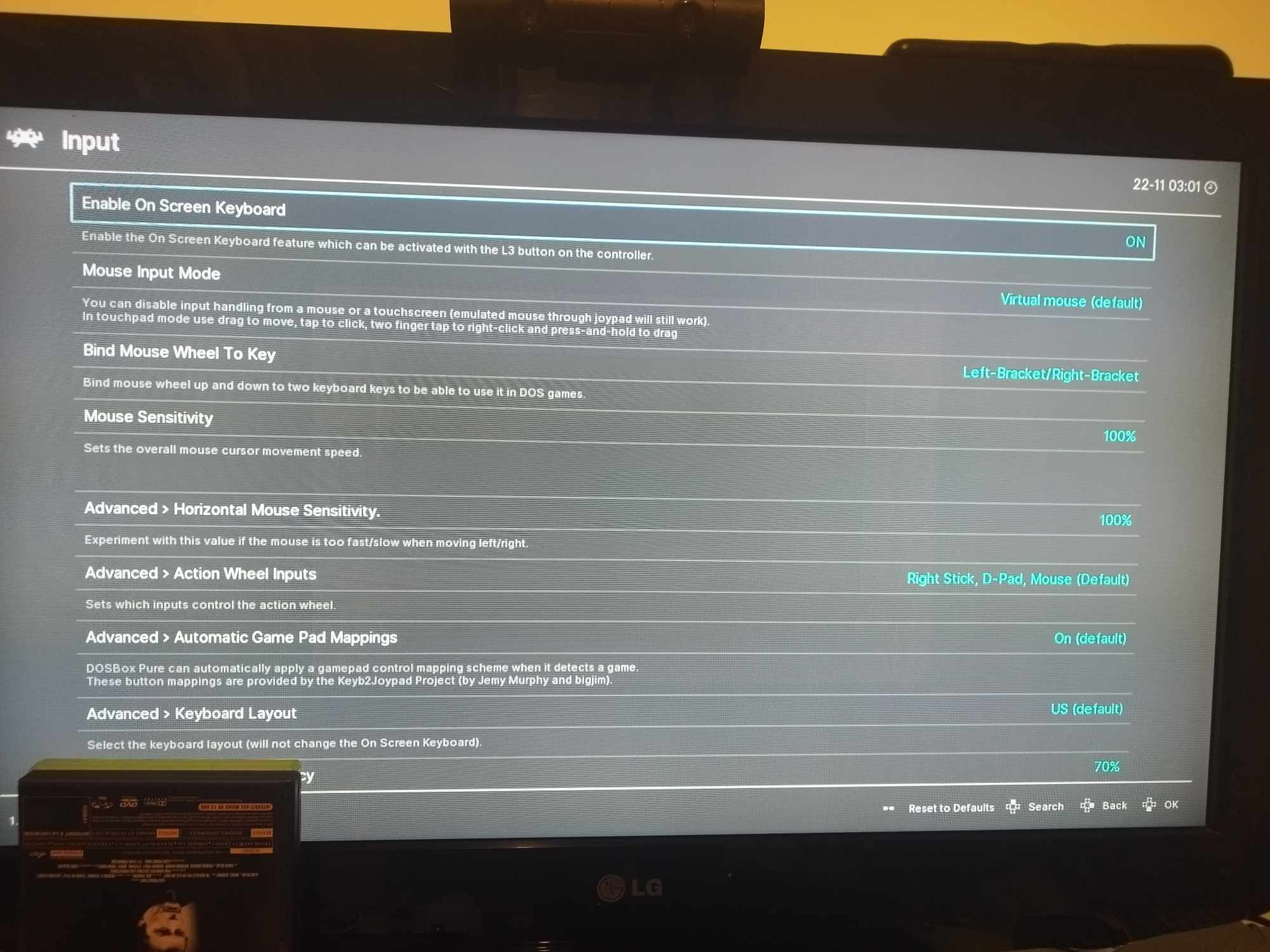

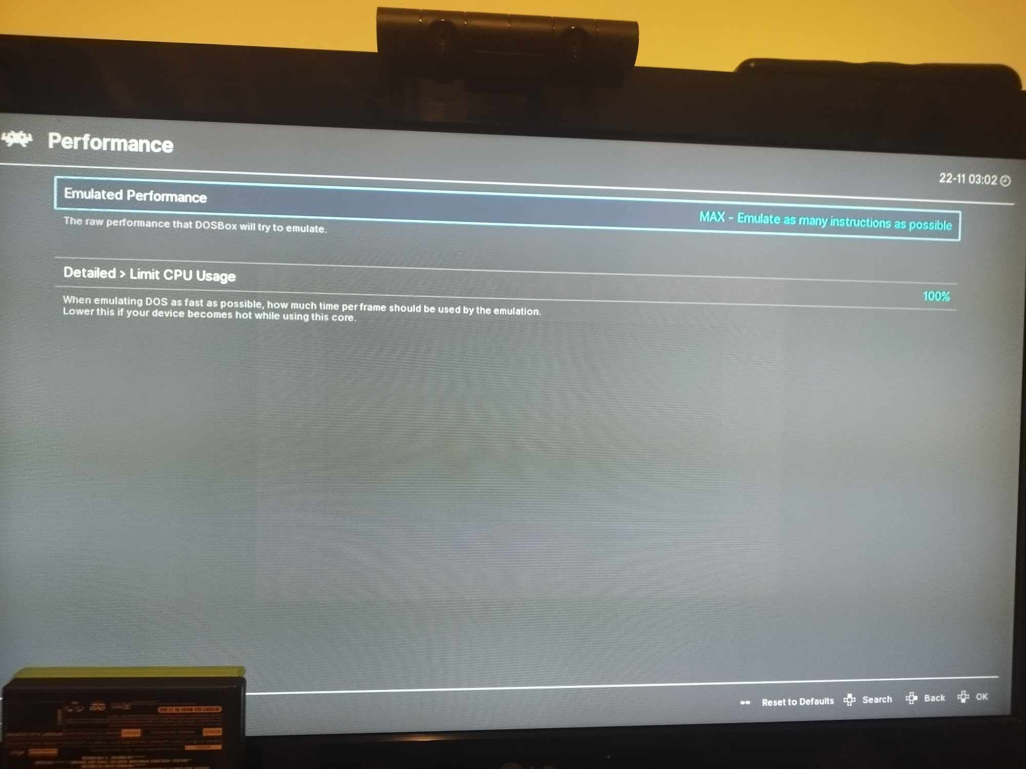

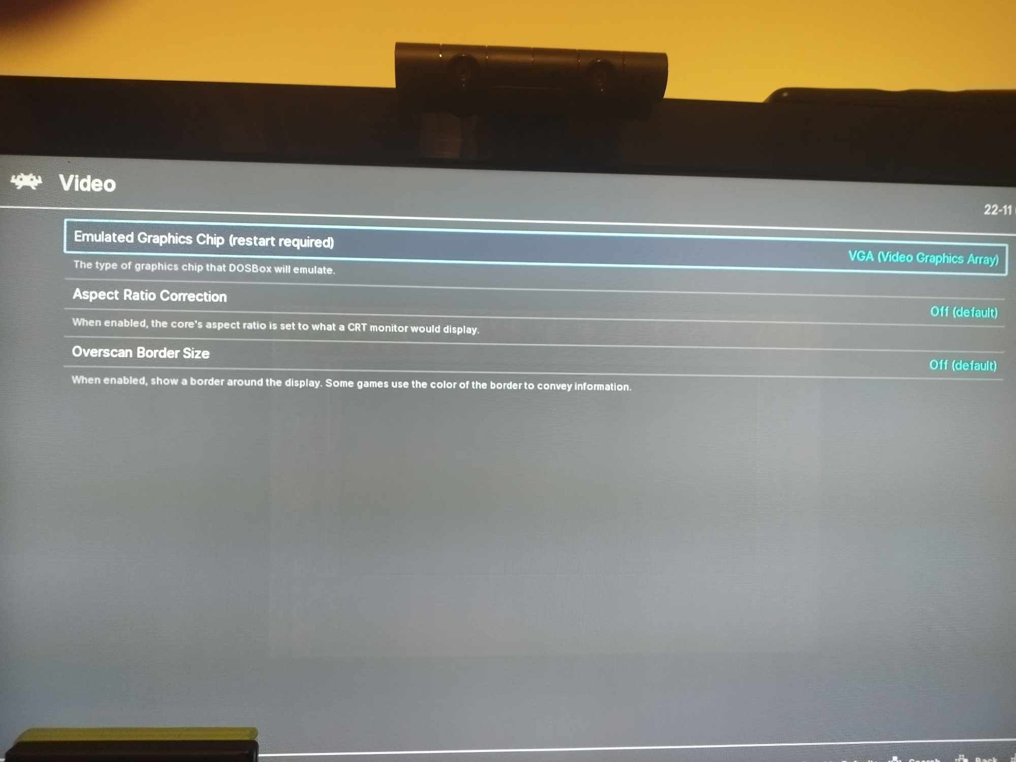

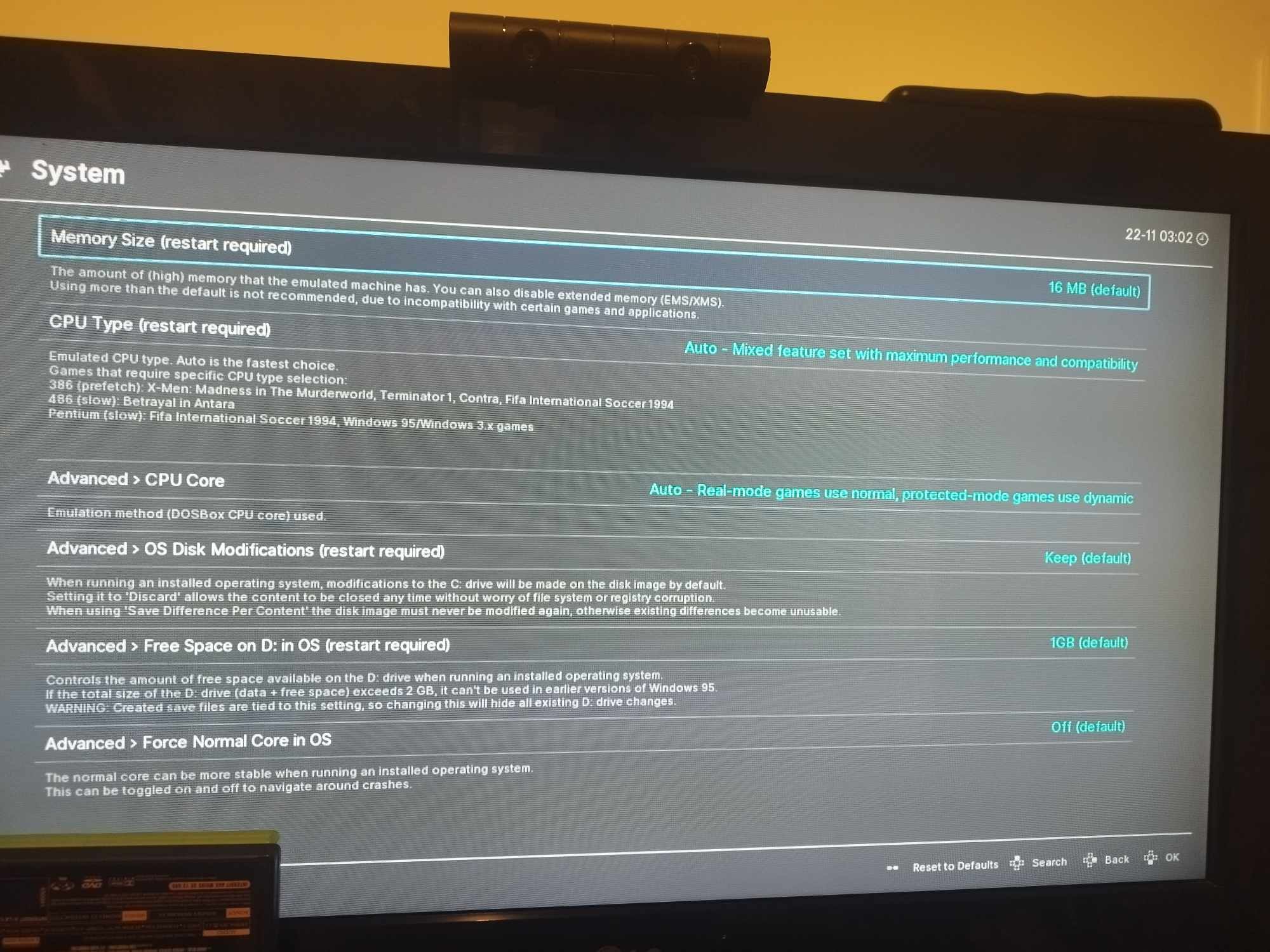

      This will work both for DOSBOX and DOSBOX PURE
      Dosbox Pure will help you running the game without a Keyboard (and also use Save States)
      Dosbox (normal)

      DOSBOX PURE :
      The difficulty here is to have the correct ratio. You'll need to activate "Pixel Perfect" (or "Integer scale") on the Recalbox Setting menu first.
      Also maybe you need to put 16/9 here, I'm not sure :
      Then on Dosbox Pure, Just follow those parameters :
      The game should run at full speed on a Raspberry Pi4
      Pi5 may autorise rewind also (Pi4 can't handle it).
      Please note that Dosbox Pure will also let you use save states... which is VERY useful in that game.
