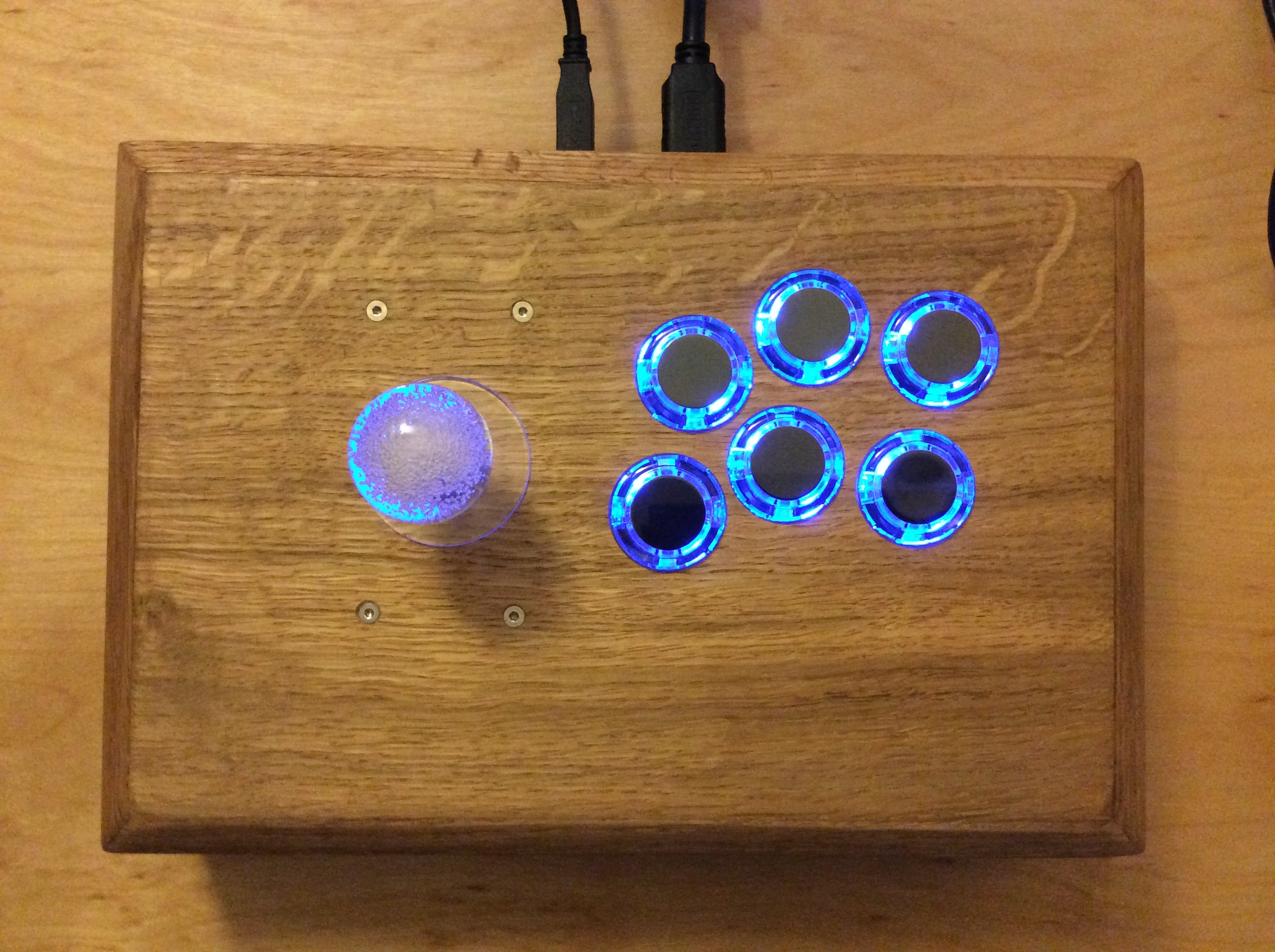

      My recalbox is housed inside an arcadestick that I made that has buttons the light up. I wrote a simple python script to turn the lights on and off. At one point I had RetroPie installed and I placed a couple of .sh files in tehe "Ports" folder and I could run them from the Emulationstation UI.
      Recalbox does not have this folder, and I haven't been able to figure out how to make this work as I would like. Can anyone help?
