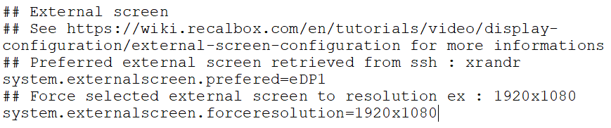

      i opened the recalbox log, as described, and found that lines:
      Connected screen(s) / Max resolution / Fallback resolution lower than FullHD:
      eDP1;1920x1080;1920x1080
      Force selected output eDP1, disable others
      xrandr --output eDP1 --auto
      So i changed the values in recalbox.conf to:
      But still the same prob, boot until emulationstation bootscreen then it goes black.

        i already found the solution.
        the value eDP1 was for the internal display from the notebook. i had to use HDMI1 instead.
        now everything works fine.
