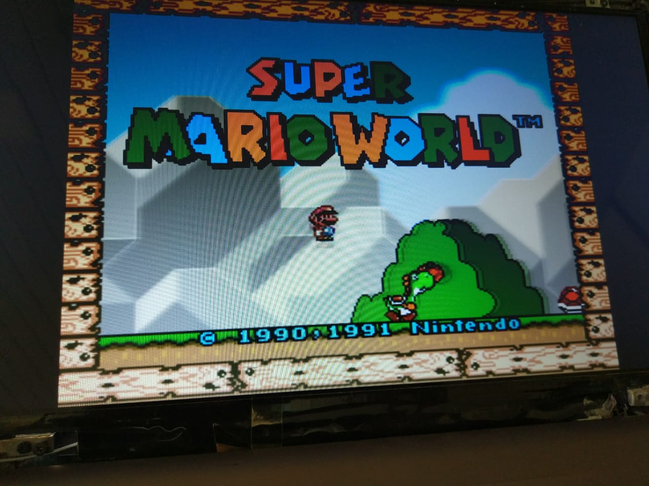

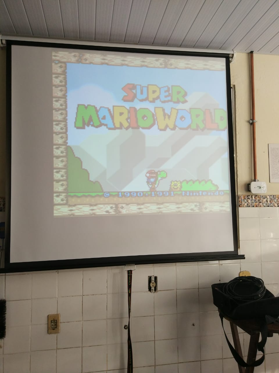

      Hi Guys,
      I'm using Recalbox system(Build 64055288 from pipeline 20811907 based on 18.04.20 ) x86 at a HP pavilion DM4 a laptop, works great, but when i tried use with a projector, the screen has been cut, beacuse the laptop is widescreen and the projector is 4:3, beacuse that 1/4 of the screen don't show for me. I tried to change the video ratio 16/9 to 4/3, but looks like as the screen showed is widescreen was cut.
      i tried change same stuffs at recalbox.conf like global.videomode, but continued the same problem.
      2_1529088719144_WhatsApp Image 2018-06-15 at 15.50.43.jpeg 1_1529088719144_WhatsApp Image 2018-06-15 at 15.50.42(1).jpeg 0_1529088719144_WhatsApp Image 2018-06-15 at 15.50.42.jpeg
      Thanks in advance
        Substring @Joaomg last edited by
        @joaomg videomode just works on ip, there is no option to change the resolution on PC yet as it's using the display native resolution. But you may jave a look at the wiki, english mini how to, to change the resolution (once for all)
