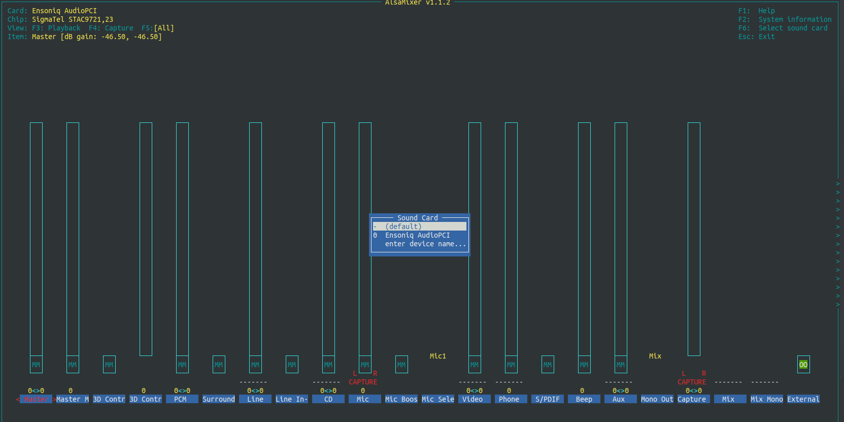

      I updated two pcs (x86 and X86_64) with 18/04/2018 update. All is fine except the sound after reboot.
      The update seems to loose sound config and mutes all the sound card output.
      To reactivate the sound, plug a keyboard, just press F4 to exit ES, log into recalbox
      login : root
      password : recalboxroot
      run alsamixer
      # alsamixer
      you should have that :

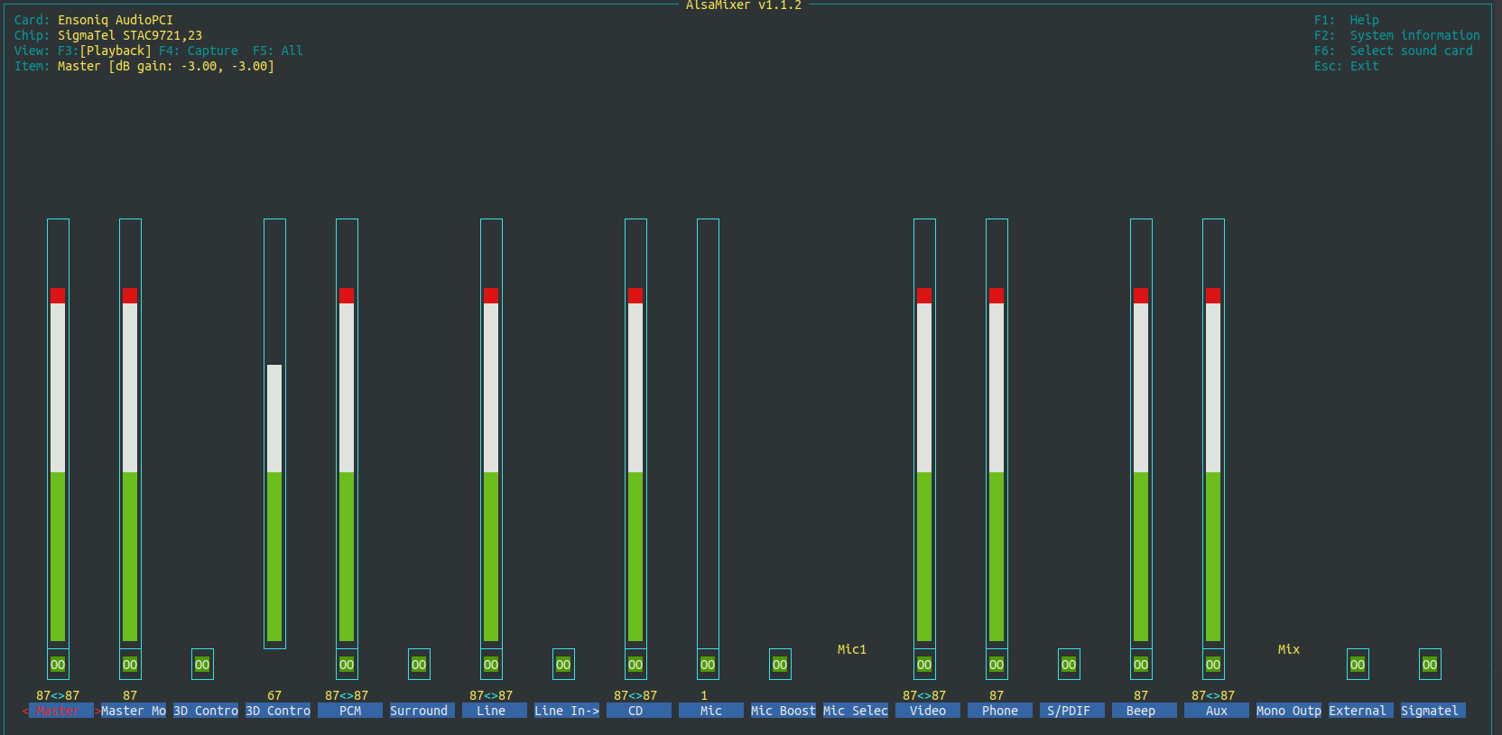

      unmute all the items with the "m" key and increase at least Master and PCM
      The sound should come back.
      Exit alsamixer with "ESC" key
