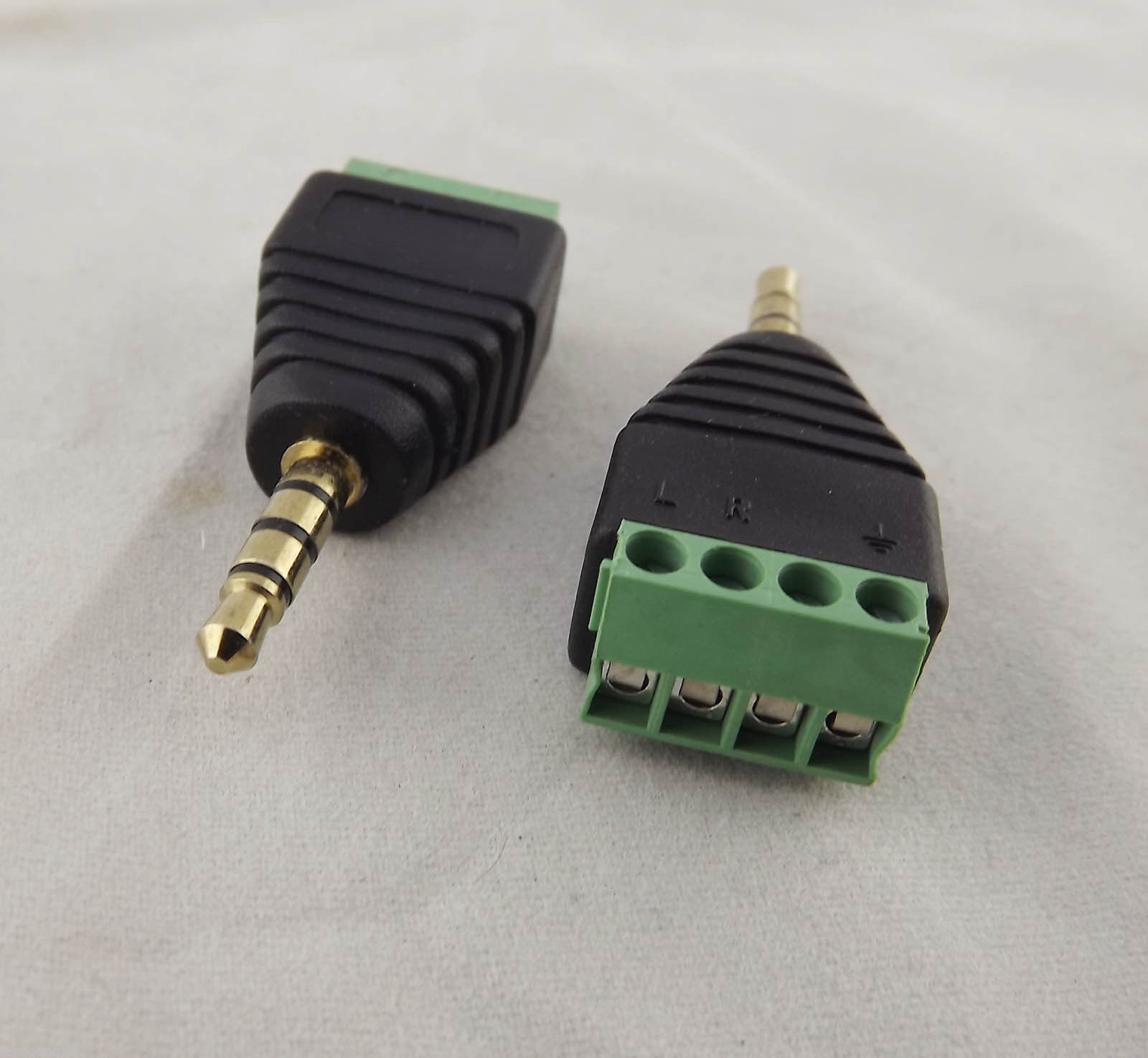

                I've bought the following adapter in ebay to fix my old cable and have the proper pin connections:
                The adapter is coming from China so it will nedd a few weeks to arrive.
                I thought that connecting the raspberry via 3.5 jack connection I will have a video image like the classics arcade. With the feedback from "tifsmo" I'm worried if it's worthy all this effort.
