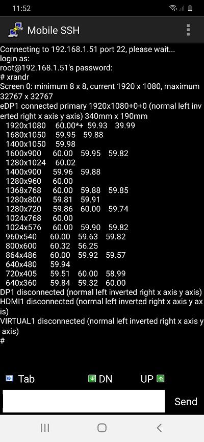

    Problème PC HDMI TV ecran noirposted in Recalbox GénéralBonjour, j'ai suivi ce tuto mais le problème persiste toujours. https://forum.recalbox.com/topic/22369/recalbox-7-0-1-sur-pc-portable-vers-ecran-tv?_=1610231531821 Je vois le logo d'ouverture recalbox qui s'affiche sur ma TV , ensuite l'écran devient noir "pas de signal"
 J'ai tout essayer mais il n'y a rien a faire.Voici mon xrandr

    RE: Recallbox 7.1.1 PC impossible de détecter HDMI TVposted in Recalbox Général@biskel Salut j'ai exactement le même problème que toi, j'essaye depuis des heures. Voici mon xrandr
    RE: Recalbox x64 Laptop to TV black screenposted in Recalbox General@Zing The HDMI conector and cable have no problems, it works with my PC and PS4 and other TVs, I even tried another cable. When I start recalbox I can see the splash screen on my TV then black screen. On the splash screen the TV show the source as HDMI1/DVI 1366x768 @60hz. I tried this resolution too with disabled/enabled forced 60hz, still nothing. I have tried all the name output I see on xandr. I change the X into x when I write the resolution and I also tried to force the 60hz. Still nothing.
    RE: Recalbox x64 Laptop to TV black screenposted in Recalbox General@Zing I just did thx but still nothing...I also corrected the HDM1 into HDMI1
    Recalbox x64 Laptop to TV black screenposted in Recalbox GeneralHi everyone. I created a recalbox on an usb key to use it on my laptop, it's working like a charm.
 But when I try to connect it on my TV through HDMI I see the logo menu on both screens but then I have a black screen on the tv and my laptop screen still displaying recalbox as usual.Of course I made some research here.
 https://recalbox.gitbook.io/documentation/tutorials/video/display-configuration/configure-an-external-display-x86-x86_64It seems that's easier to do this since the 7.0 update. Anyway I don't have another computer, so to connect to the ssh thing I'm using my android phone using Mobile SSH app.  Then I go on recalbox conf in share/system and I write this : Prefered external screen retrieved from ssh : xrandr;system.externalscreen.prefered=HDM1 Force selected external screen to resolution ex : 1920x1080;system.externalscreen.forceresolution=1920x1080 But nothing happens, the problem is still here, I have tried different resolution but nothing works. Can someone help me ?
