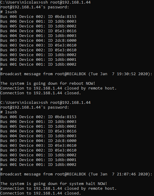

      Below the output of the "lsusb" command without the dongle and below with (no difference as if the dongle didn't work):

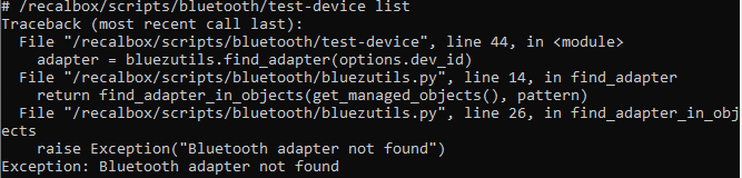

      Not surprisingly the command "test-device list" returns an error:

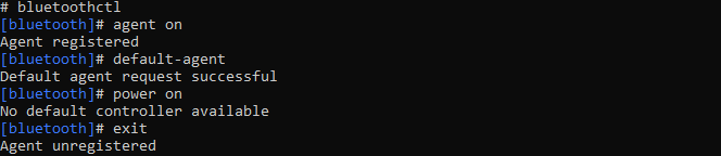

      Ditto for the "bluetoothctl" command:
