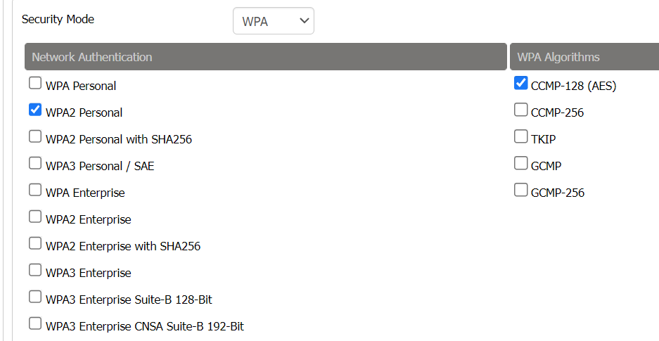

    • RE: Recalbox 8.1.1-Electron: Wifi not connecting
      @alvin I've tried both, including 2.4GHz.
      I checked that page for enabling wifi, and I am using WPA2, as it says. However, there are some other options in my router along with that (such as the WPA algorithm) and I'm wondering if that might be causing a problem with the CM4/Recalbox. For the WPA algorithm, my router is set to use COMP-128 (AES).
      As far as WPS, my router does not support WPS (I'm using the DD-WRT firmware, and they say DD-WRT does not support WPS due to inherent security issues.
      posted in Recalbox General
      CalicoSkies
      CalicoSkies
