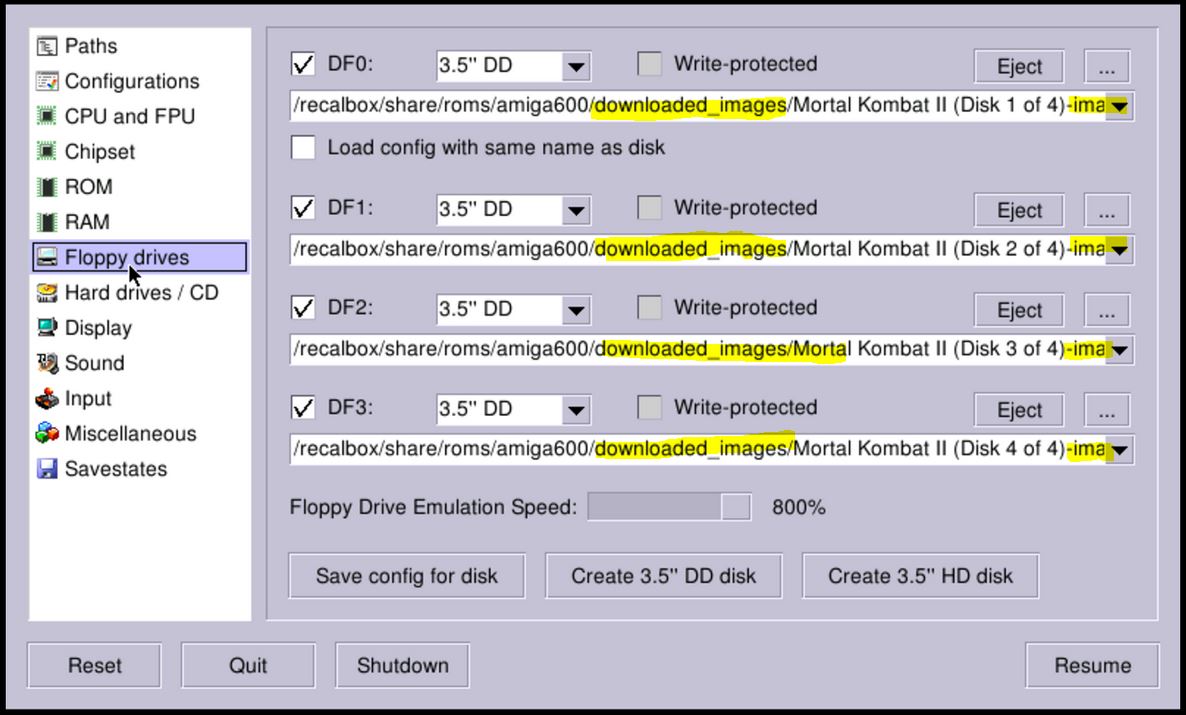

                                            Oh ... a bug?
                                            Games (2+ Disks) don't work after scraping:
                                            "Fresh"-Amiga600 (Amiga1200)-Directory.
                                            Content ONLY *.adf
                                            Start Recalbox
                                            Go to PC: open Universal_XML_Scraper
                                            Scrape.
                                            UXML creates a gamelist.xml
                                            <game id="33236" source="ScreenScraper">
                                            	<path>./Mortal Kombat II (Disk 1 of 4).adf</path>
                                            	<name>Mortal Kombat II</name>
                                            	<desc>Something Blbablablablablabala....</desc>
                                            	<image>./downloaded_images/Mortal Kombat II (Disk 1 of 4)-image.png</image>
                                            	<image/>
                                            	<rating>0.75</rating>
                                            	<releasedate>19941118T000000</releasedate>
                                            	<developer>Midway</developer>
                                            	<publisher>Acclaim Entertainment</publisher>
                                            	<genre>Kampf</genre>
                                            	<players>1-2</players>
                                            	<region/>
                                            </game>
                                            And it's create a sub-dir: downloaded_images/
                                            You see: Path -> OK .. it's Disk 1 and ADF!
                                            Now starting this Game: "Please insert Disk" ?! -> UAE-Menu:
                                            Scrape with ingame-Scraping don't work - its find only Console-/Arcade-Games. Not the Amiga-Versions. Pure Amiga-Game: don't find. I think it happens with the Amiga-Support @ 4.1 -> No Amiga -> No "It's Amiga-Game"-Info zu scraping-Site.
