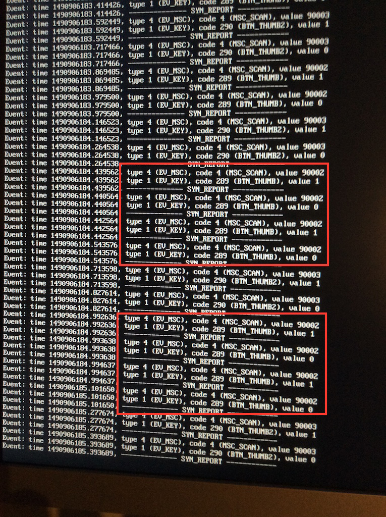

                              @Substring with evtest i see that sometimes a button triggered 2 times. i testet 2 buttons alternately and marked the lines when it triggered 2 times.
                              the other problem i have is, that the encoders don't detect at starting the system. i have to disconnect and plug in again.
                              PI3 / recalboxOS 4.0.2
                                Substring @funkybunch last edited by
                                @funkybunch This looks pretty much more complicated than I thought ...
                                You have some kind of ghost rebound on your controller, but is it a hardware problem or a a software problem ? I definitely can't tell ...
