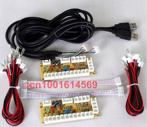

                            • peterpan123123
                              peterpan123123 @Substring last edited by
                              @Substring I still got a weird problem. Neogeo uses FBA and works perfectly. FBA does not detect any Joystick, even it should be the same core? I configured, that the config should be saved per core. Even deleting all the configs in .config didn't solve the problem.
