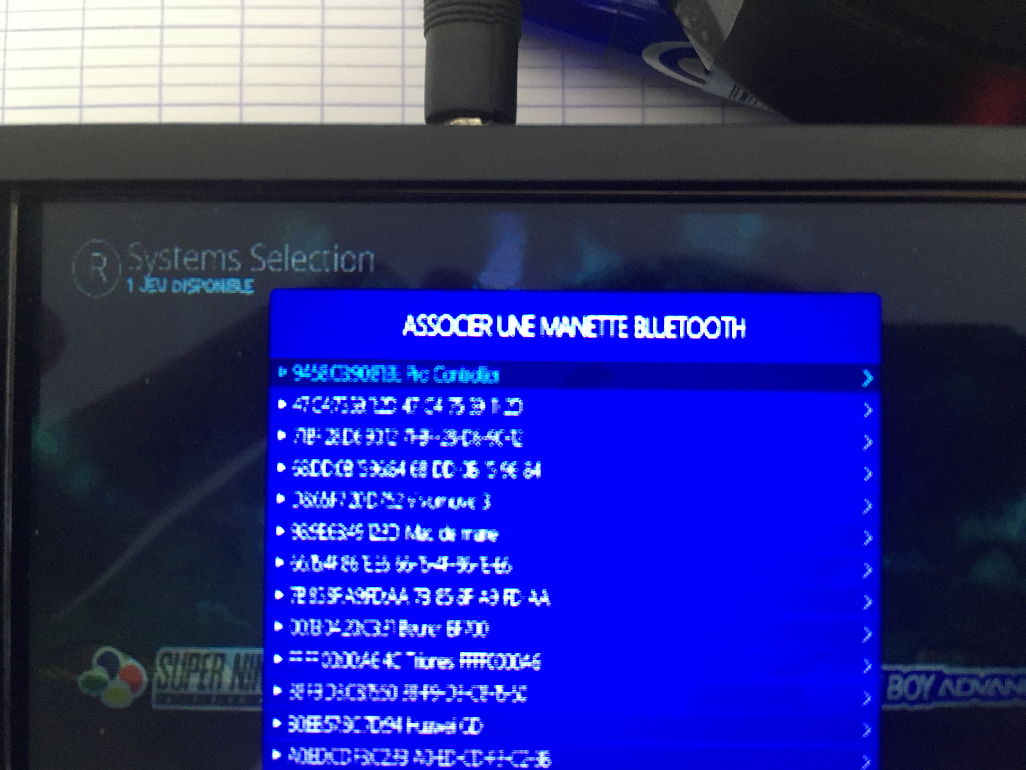

      I'm hoping there's a way to pair my Switch Pro controller in Recalbox. If there is, can anyone send step-by-step instructions? Many thanks!

        @joe-berndt yes i have the pro switch controller ,it work on recalbox
        instructions:
        1: go to the recalbox associate bluettoth controller
        2: make a long press on the verry small button at left of usb (you listen a click)0_1584697079938_IMG_9326.JPG
        3:press on associate a bluetooth controller at the same time as you press the small button (make a very long press on the small button)wait, your recalbox will have found bluettoth devices including one called pro controller press on it
        4:your swith pro controller is detected go to configure controller and your controller is detected
        ollow the instructions to configure a controller and your controller will therefore be operational (at each start of the recalbox (the recalbox must find the controller) you have to do a long press on the small button and go to configure a controller and it will appear
